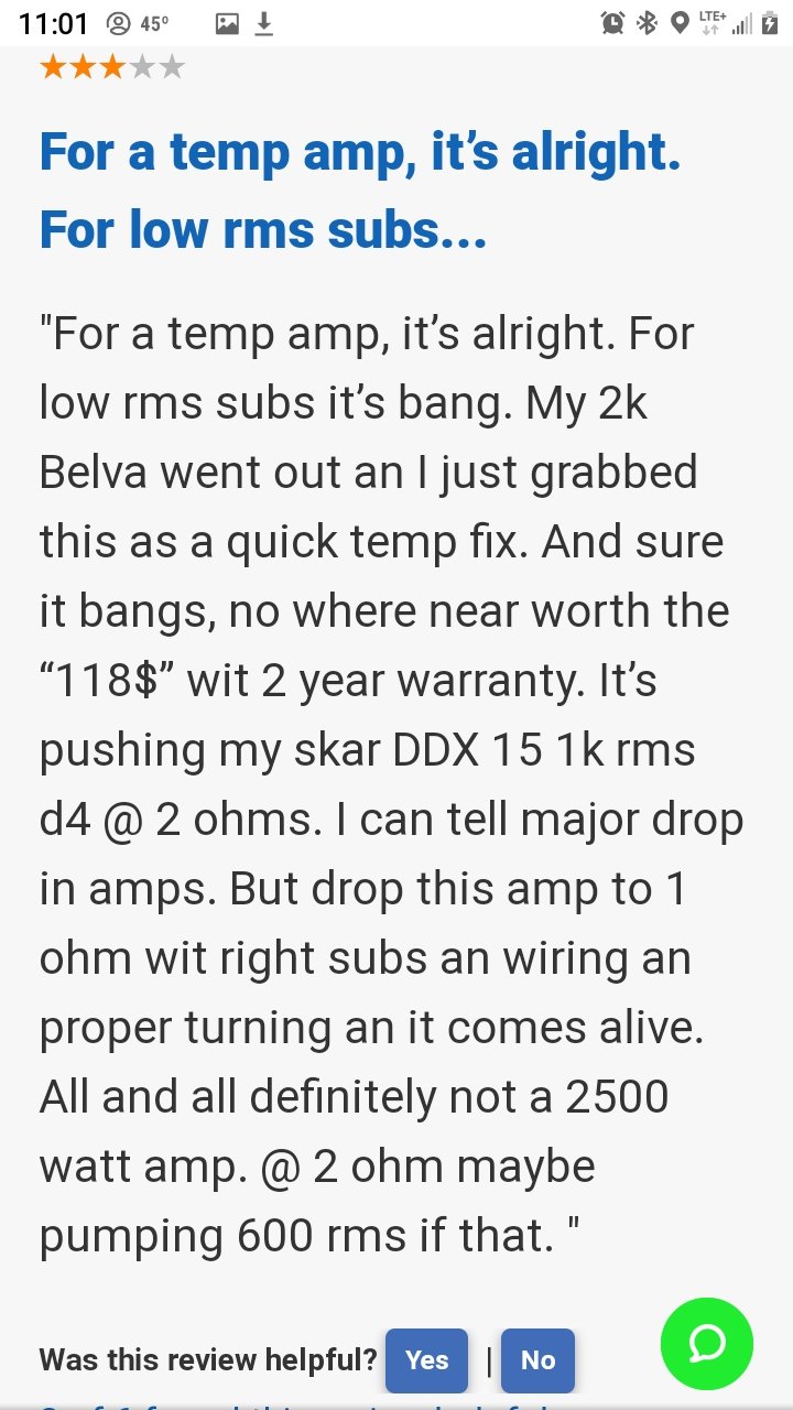

it’s a 600 watt amp at 2 ohms. Your dual 4 wires to a final 2 ohm load. So, no it would not be a good idea to split that amps power to two subs wired at 1 ohm. That would 200-300 watts going to each 1200w rms sub.Get a new amp
I'm not really familiar with amp ...I did a quick search and found people were dropping them to 1 ohm . I copied one of the reviews but your right I looked it back up and it is a 2 ohm mono amp. The reviews had confused me on its ratings ....
