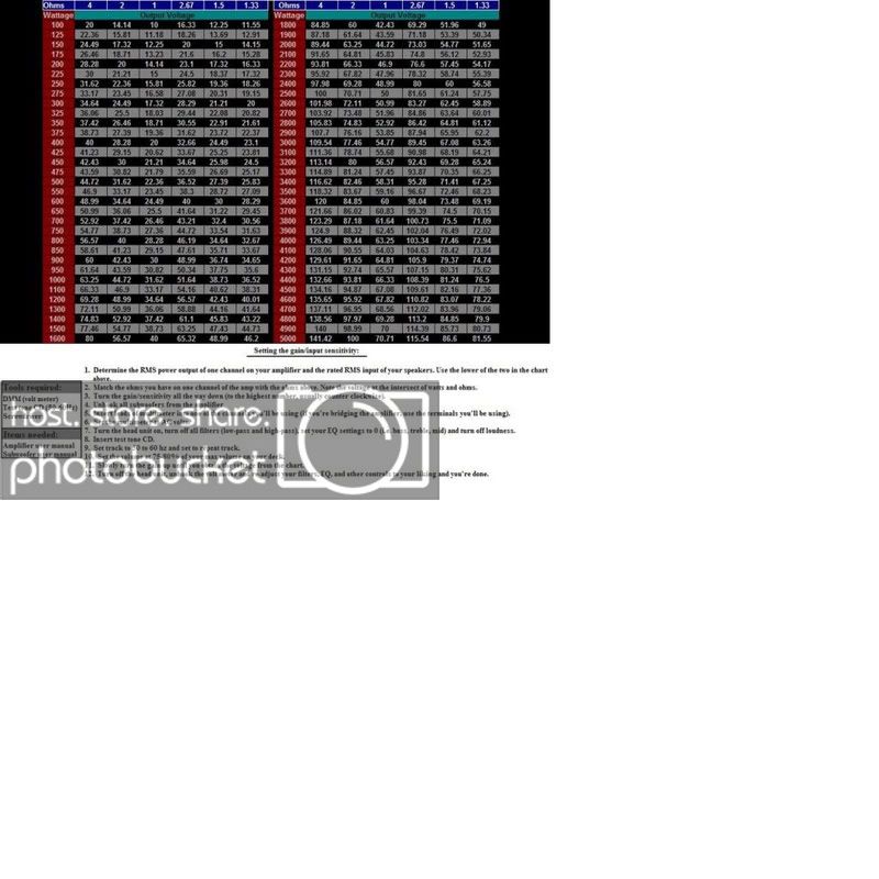

I think so?? My plan is to us my DMM and a 60Hz tone and set the a/c output voltage.
I found a nice chart converting a/c voltage to watts but I am not sure where I saw it? I am not sure how this method can be accurate given the fact that true ohms can be difficult to measure and the chart is based on knowing your exact ohm load.
i have the chart i can post it for you..
That will help a lot!

Wire the 2 subs together into a 4ohm load then check that lead with a DMM, pretty simple....
