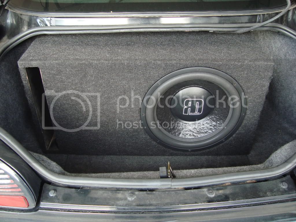

ya i got 4 cubes in mine easily. with out cutting or building the box in the trunk i dont see fitting an 18. the trunk opening sucks and behind the rear seats without cutting the medal is hard to fit a big box in.
i had 3.3 cubes for a 15" and it BARELY fit. like, i had to put all my weight on the box to get it to slip past the trunk opening. box was 34 x 15.5 x 17.5.
Is this 34w x 15.5d x 17.5t?
Could anyone else post dimensions is they could, thanks!
I had fit a 28"x32"x11.5" box last summer, but had to slide it from the inside. Glad I never had a flat tire with that box lol.
im wippin' a 34.5"x21.5"x14.5" (WxDxH)box...(4.96 cubes before displacement w/ 3/4" MDF not sure if it will come out to be honest, bout to do a build myself for and HDC318 in 3.7 tuned to 38.5hz w/ 2 6in round ports that stick out approx 6" or so..
I got a 5.5 cube box in my ponatic sunfire lolllllllllllll smallest trunk ever
Just because they are both pontiacs dont mean there anyting alike. Ive owned a Cavalier [sunfire], And installed a system in a GTP and let me tell you there is NO resembalince as far as fitting a box threw the trunk opening. Thats like me saying since my 83 grand prix's trunk can fit xxxx box, his Grand prix should as well.
