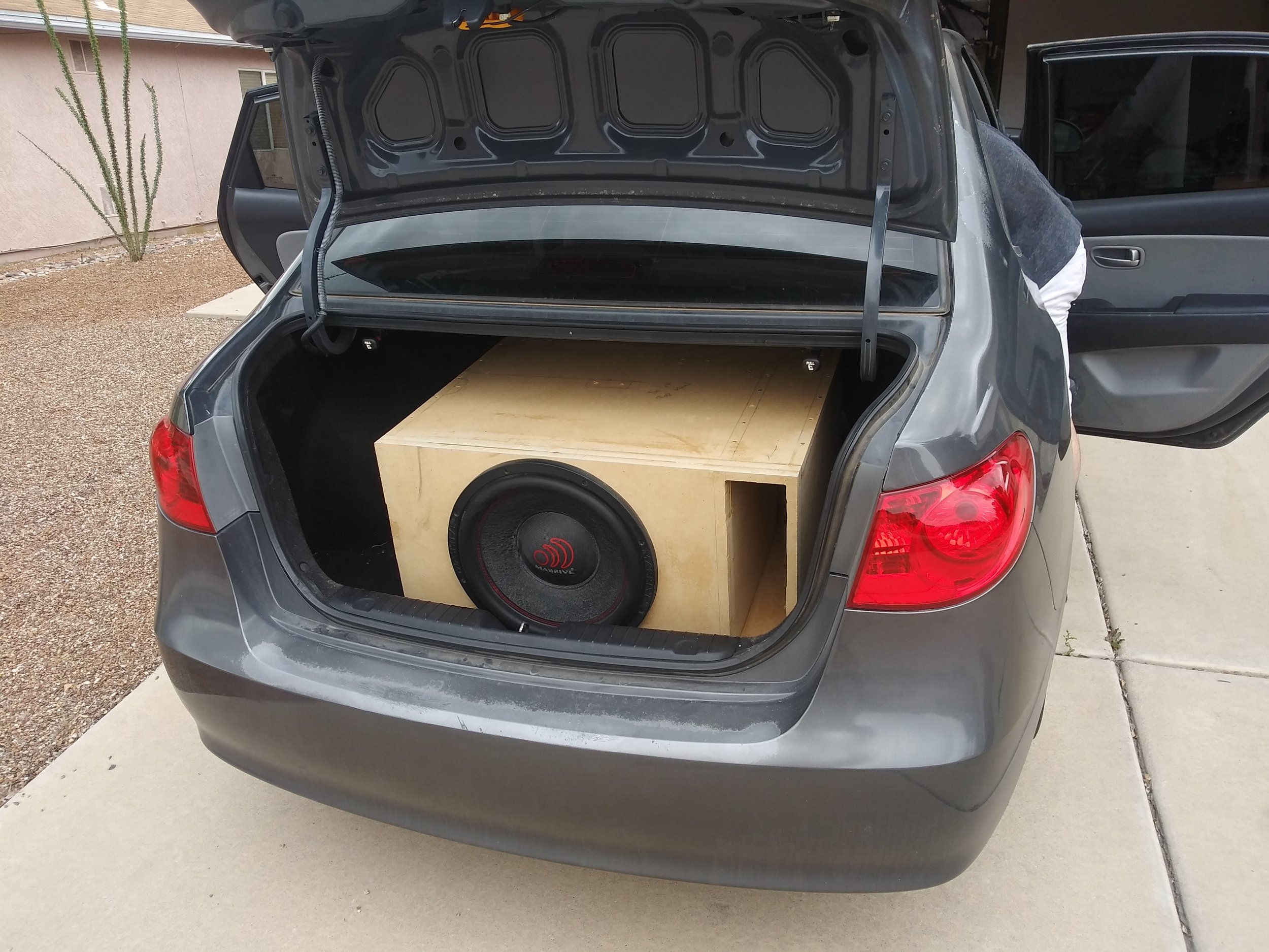

We just put a single Hippo 15 in an Elantra sedan on a prototype fullbridge 3K, that trunk opening will limit what U can get in there so be careful unless it's to be built inside the trunk.
21650
Granted... we COULD have gone slightly bigger but not much... it barely dropped in as it was.
