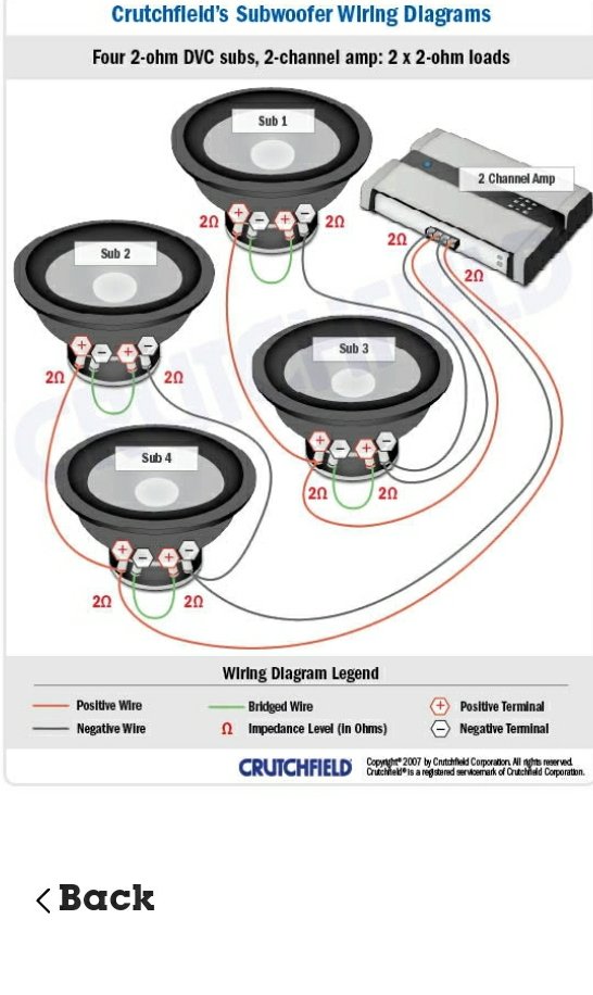

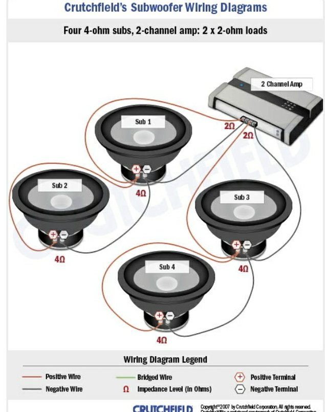

It's been a while since I've had a system. I still have my old school rockford fosgate punch 800.2 from 20 years ago. Still works fine. I'm lost with all the new tech out today. If anyone can help I am wanting to use 4 subs with this amp like I had back in the day. Can anyone give some advice on what speakers I could use without breaking the bank and the best way to wire them. 2ohm 4 ohm so on. Any help would be greatly appreciated.
You can get DVC subs if you want to. Both of these diagrams should work for you. I'm assuming that is a two channel amp.

Wire 4 of these down to 2 ohm. That amp should be 2 ohm stable. Id recommend placing a fan on that amp to keep it cooler
It is a 2 channel, so only stable at 4 Ohms bridged.
