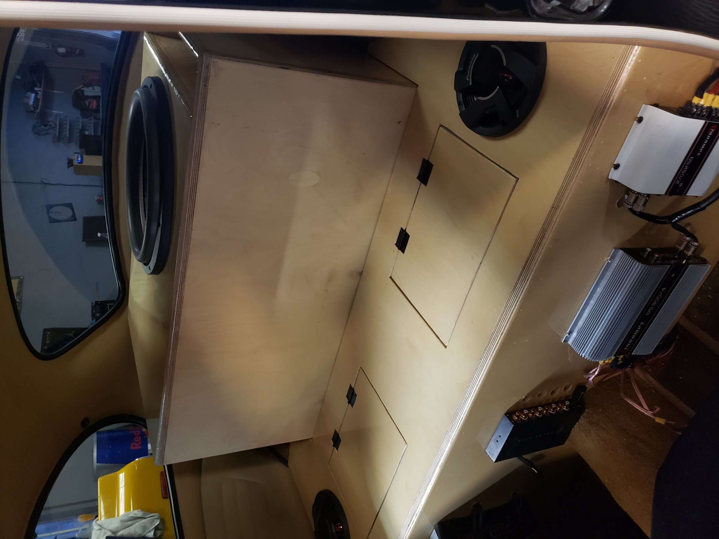

Single 15" AB HD15D2 in 4 cubes net at 32hz on a MD3000.1 @ 1 ohm.
nice build
anymore pics?
is that one whole enclosure? or a platform then enclosure
Enclosure first, then built the platform around it. All brad nails, titebond II and clear silicone. Then wood putty to fill in nail holes. Five coats of clear. Wet sanded between coats of clear. Probably, the wrong section, again.

very nice build
maybe ill do the clear coat
looks nice
im assuming its a dd but i cant tell
