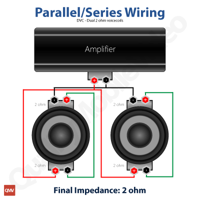

i just added a 2nd sub but dont know how to exactly wire it
i always used the 1 ohm so my positive to one side and negative to the other side
my blue and black is my new sub
and red and green is my old sub
as the way theyre wired is it okay?

yikes does that mean i have to wire both of them to get 4ohms?
same as i bought the taramps 1ohm
should i return to get the 2ohm instead?
Dual 4 subs, one ohm Taramps. Dual 2 subs 4 ohm Taramps. People will tell you to not buy a 4 ohm Taramps, but if it works for you, then, go with it. I don't buy amps worrying about when I'm going to sell it.
