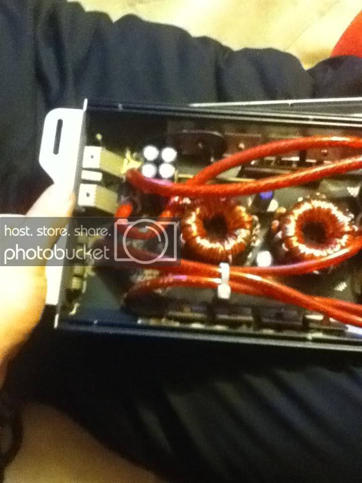

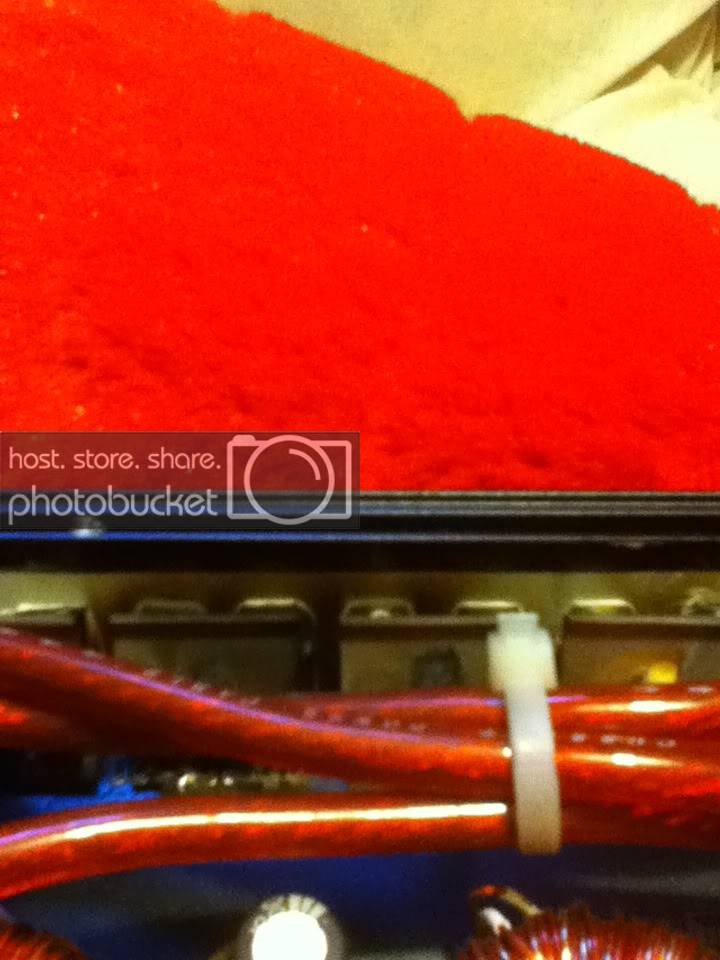

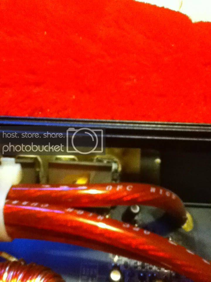

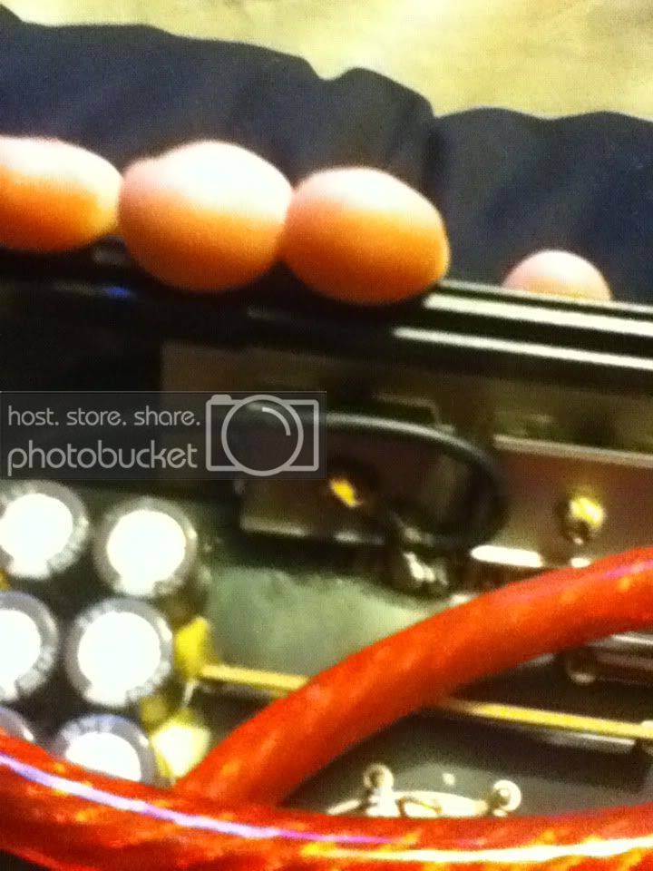

guys please dont start arguing here...all i was looking for was some help. here are pics of the guts...there seems to be marks on both sides
well, the pics are pretty grainy, but that one power supply section is definitely toast, which is probably about $40 in just parts, if nothing else was wrong. now, that should be 2 1500's strapped in one case, iirc, so there is a whole other amp with both power supply and outputs, along with the output section not pictured. the blackening of the speaker cables leads me to believe that is likely that the output sections were pretty stressed, and that their failure is the root cause of the power supply section failure. often, there is also the driver circuits/ic's that fail due to the main fets shorting them, and there are drivers for both power supply, and output sections (4 total driver circuits for this amp) the repair for those is more time consuming than simple blown transistors. another disconcerting thing i see is that glob i can't make out in the first pic. could be foreign metal that shorted the power supply in the first place? you can do a quick ohms check on the output transistors, and other power supply and get somewhat of an idea of how far the damage is, but no way of telling without actually tearing into it and checking all the circuits. to check the outputs, simply place your test leads across the legs of the transistors that are clamped to the heatsink. none should read low/no resistance, for the ones labeled either "q" or "fet"... if the number has a "d", then it's the diodes, and you will get low resistance from them normally. luck
