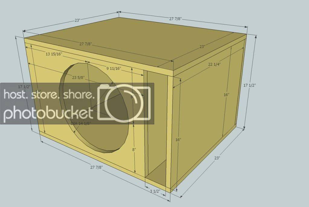

I plan on using a 3/4 inch roundover on all the edges but I run into a problem when I get to the port. The port is left of the driver and if I use a 3/4 on the inside and outside it's going to rout more of a point on the edge than a roundover.
On this pic it would be the right side wall. I suppose I could just roundover the outside edge and leave the port opening alone. Anyone have any suggestions for this. It'll be the first time I've ever used a router on a build.

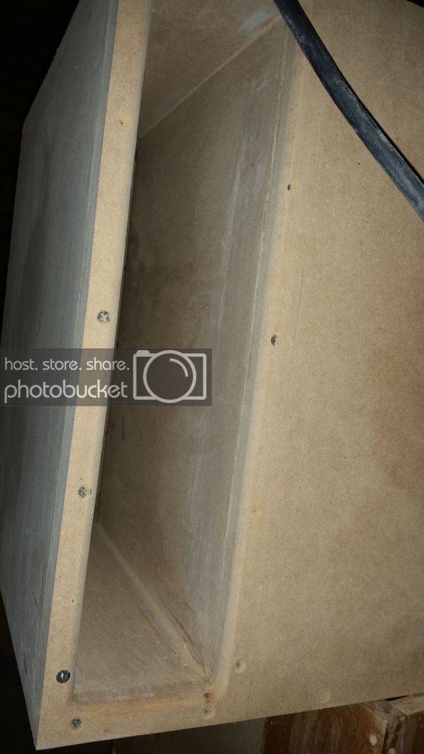

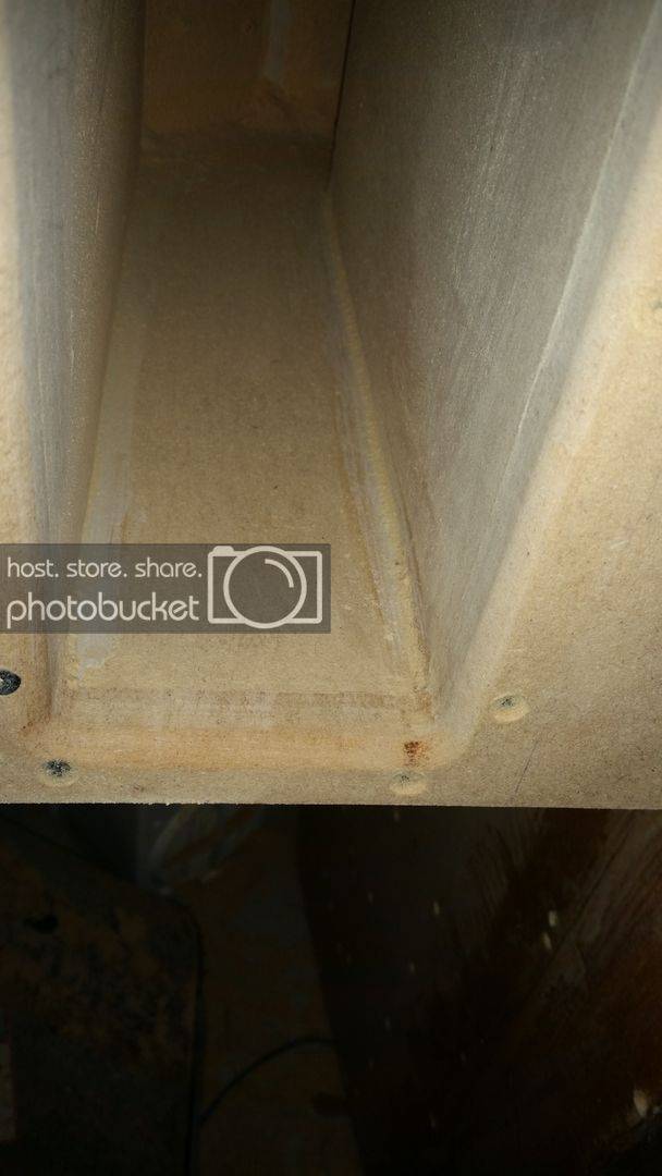

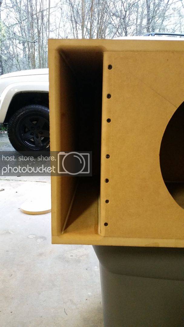

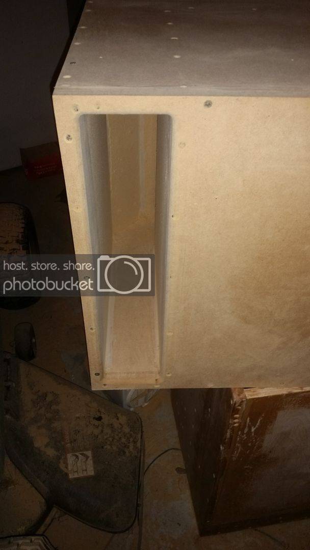

I used to do 3/8 on the port walls and 3/4" on the opening, but started just using the 3/8 all over. A larger radius will end up lopsided when doing the half moon at the end of the port. If you use screws, you'll get too close to them with a larger radius bit. I remove them to keep my bits safe, but sometimes the screw head will protrude due to the contour. Just doesn't look right.
Here's a 1/2" radius
3/8
Sent from my Motorola 2950 Special Edition 3w.
Loving the pics. Couldn't find any good ones on google. 1/2 inch looks pretty good. I am debating using screws and just pulling them or setting up my square and clamps and just using glue to eliminate the need to fill screw holes. I better jump on amazon and snag a 1/2 inch bit.
