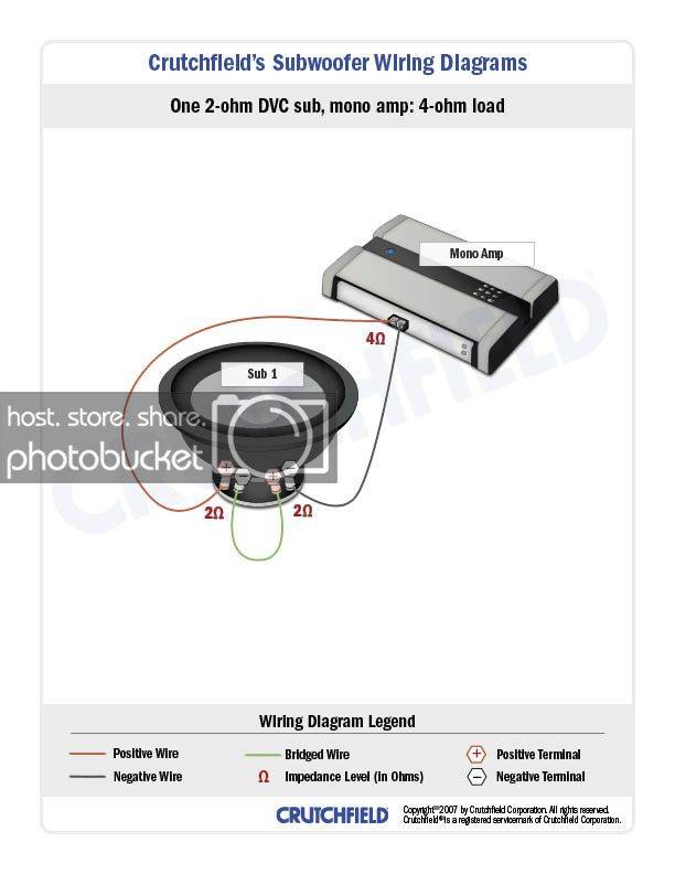

What's wrong with this picture...
I'm guessing that this moron was TRYING to wire in series... FAIL //content.invisioncic.com/y282845/emoticons/rotflol.gif.b453361716769b8110ddefc85ff03cd2.gif
That is actually correct series wiring. If it weren't correct, it wouldn't make sound at all.
Amp pos to coil #1 pos--coil #1 neg to coil#2 pos--coil#2 neg to amp neg. It is a big loop.
Yeah but he has amp positve coil 1 amp negative coil 1 and a jumper on coil 2 pos to neg - that jumper is accomplishing nothing, and yes you will get sound if you only power 1 voice coil ;-)
You sir need to look at tbat video again he has the negative and positive jumped on same coil he is actually only using one coil.
You sir need to look at that video again he has the negative and positive jumped on same coil he is actually only using one coil.
