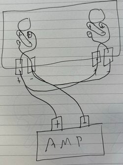

Wiring two DVC 2 ohms. I’ve viewed diagrams. Can’t find any matching specific setup with a box (just shows subs alone).
But here’s is what I’ve done. Isn’t this effectively correct? I’m still reading 11ohms and it’s barely playing.
Kicker CompR 12. Two sets of inputs each sub on opposite sides. So I assume each couple of inputs is one coil. So I’ve connecting + to - on opposite side coil. Run unwired inputs to +/- at box. Run +/- to one side of box, then wire from that terminal to opposite side of box. How is this not what’s pictured in Crutchfield diagrams?

Your diagram is showing each sub wired in series, which should give you 4 Ohms if they are DVC 2 Ohms. Then you wired them parallel outside the box which drops them back down to 2 Ohms. 11 Ohms is way off. Did you measure each coil to verify the 2 Ohms spec?

Silly goose moment. Took them out. One of the subs had reversed polarity. They are know as they should!
