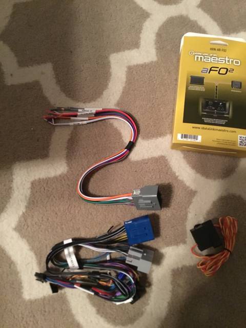

I have this plug, which I’m assuming has to be used for “universal”...
The one with the bare wires
Sent from my iPad using Tapatalk
