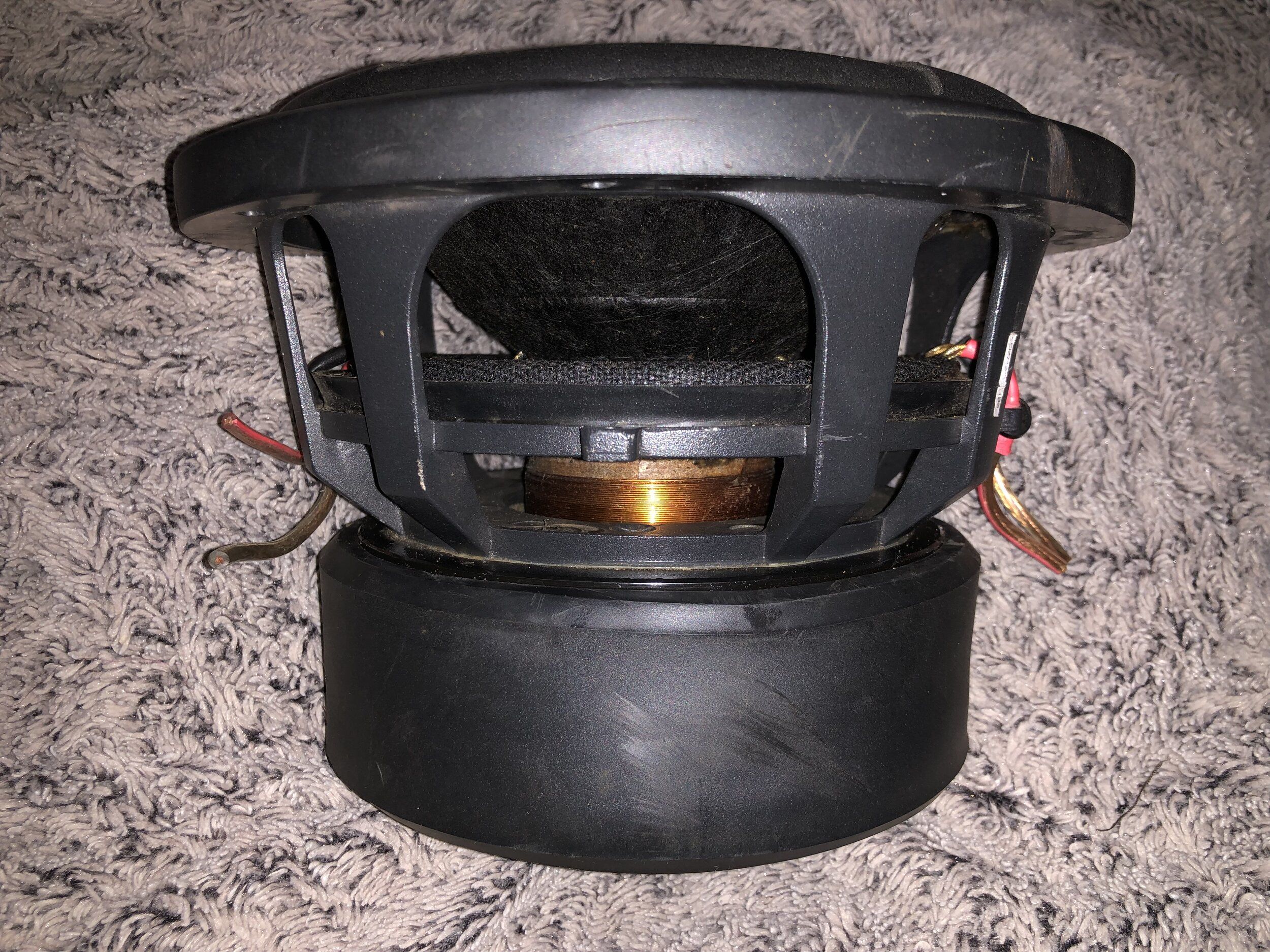

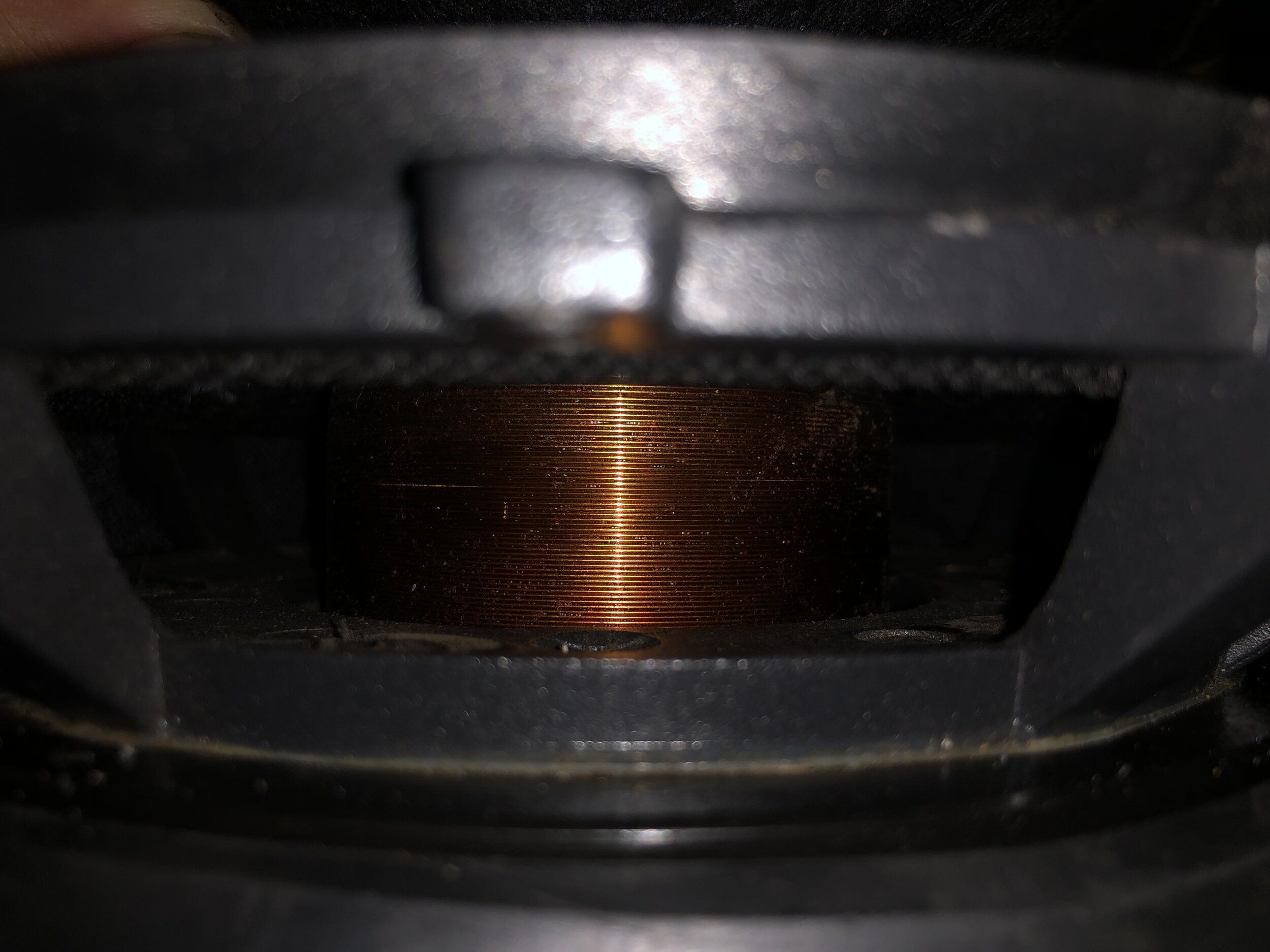

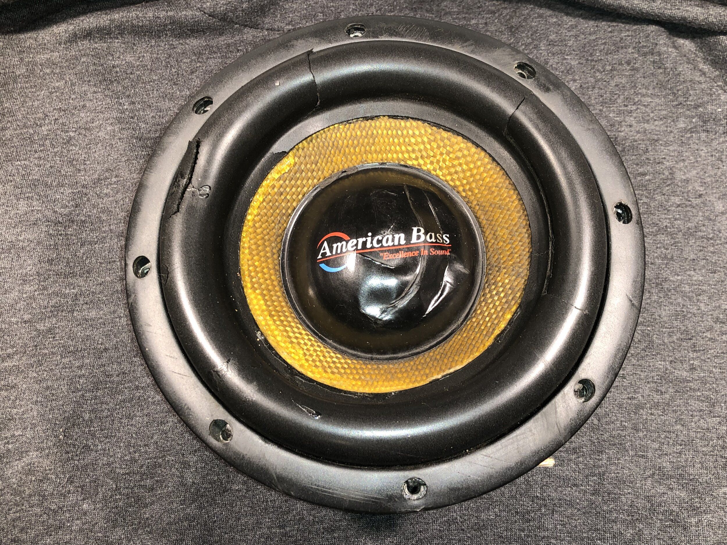

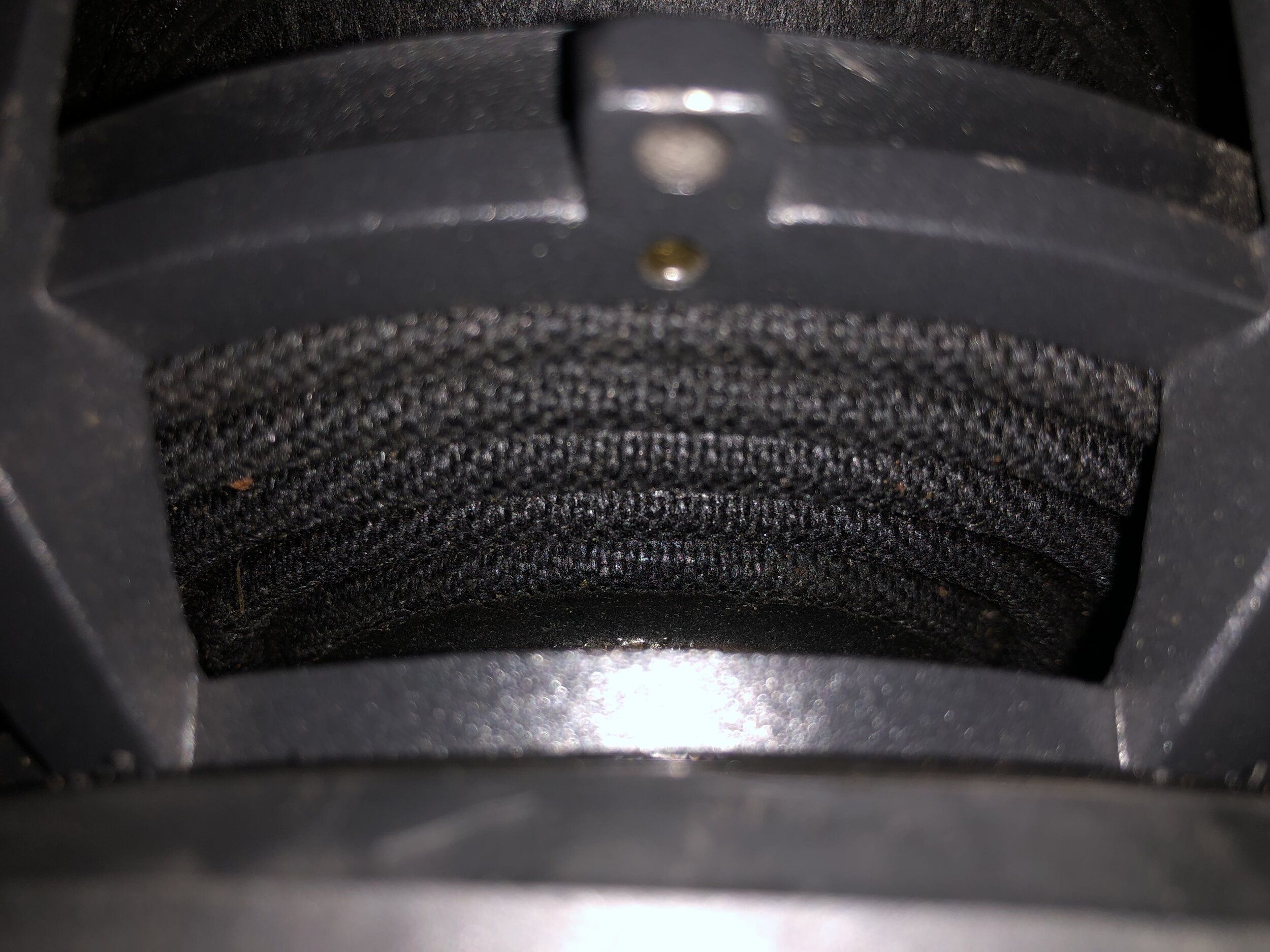

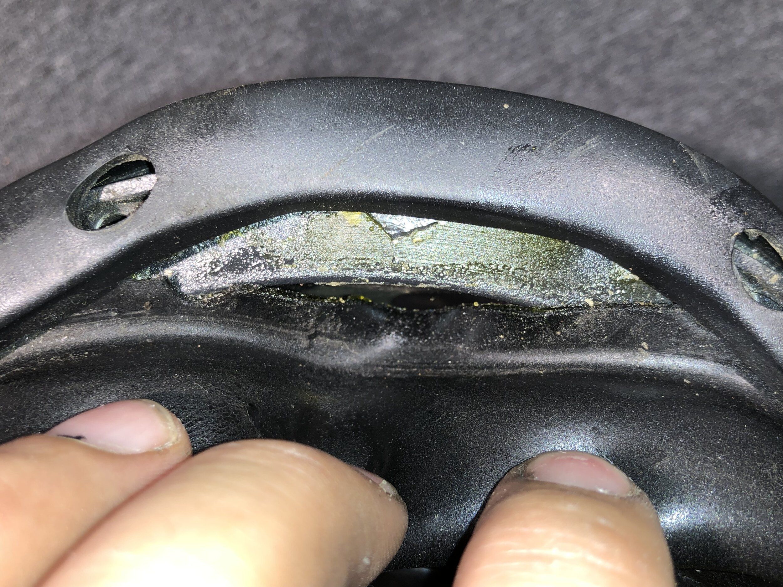

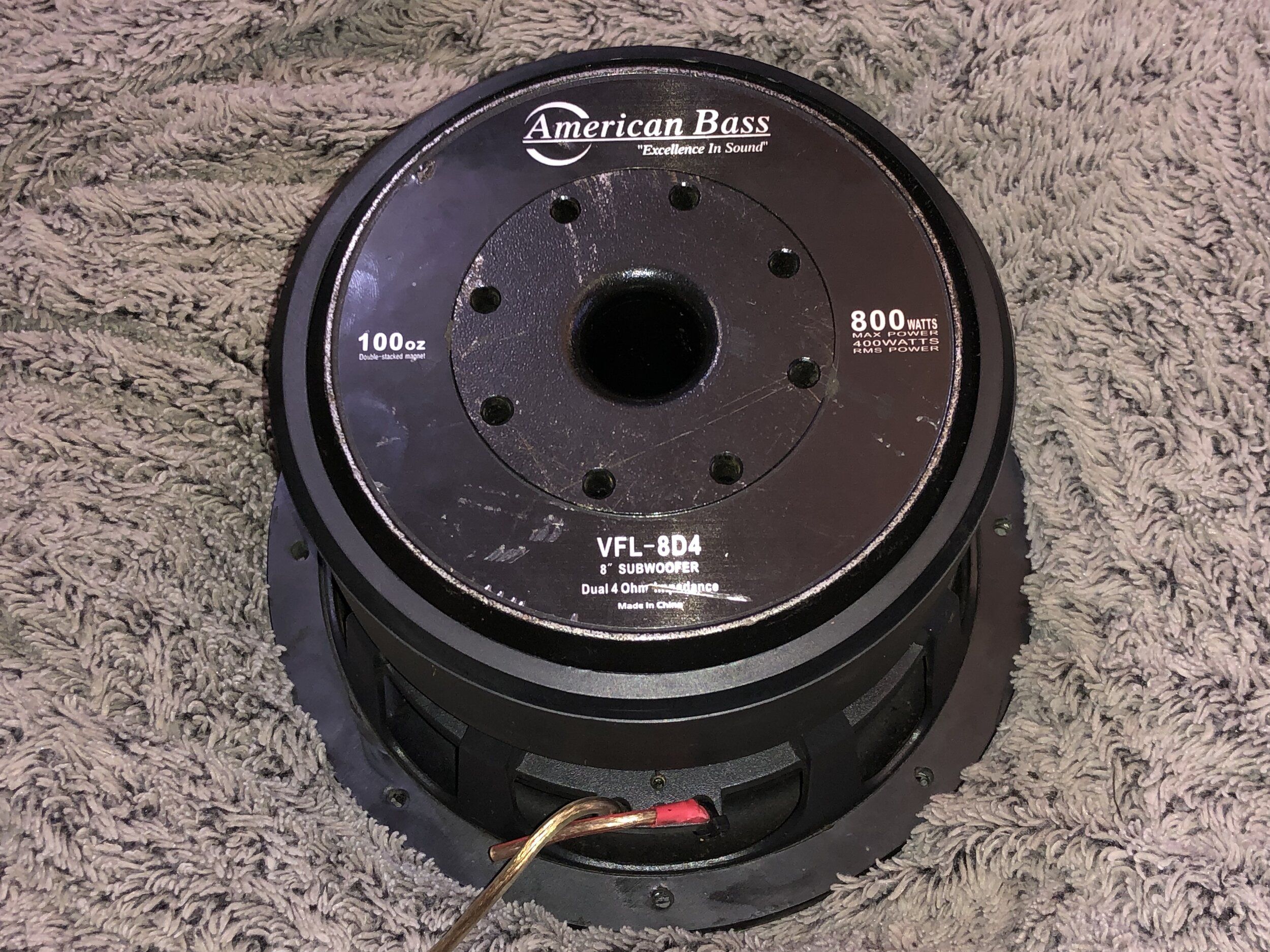

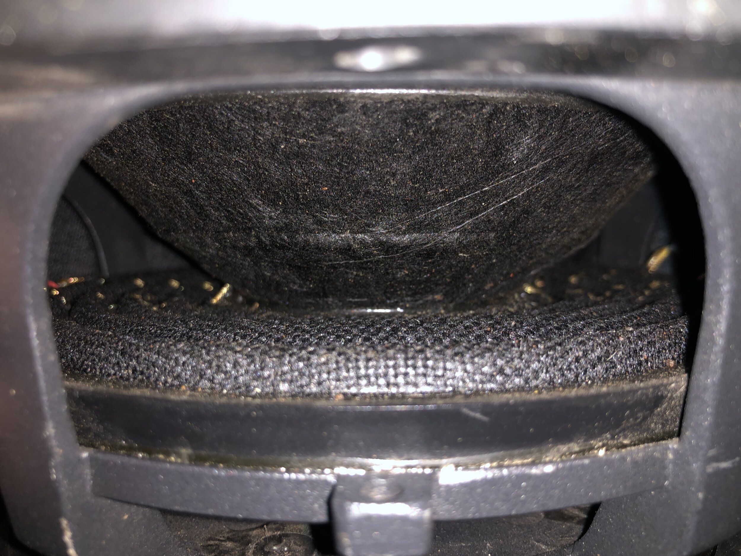

Took a load of old appliances to the scrapyard yesterday and seen this American Bass VFL-8 hiding in the pile behind my truck. I’m not really into 8’s, but figured I’d grab it. Looks like the surround came unglued as someone super glued it back down, and it tore in several other spots, also glue came undone under the gasket. The cone got oil or something on it so needs a full recone. Magnet slugs and basket look okay, no cracks.
Gave it a light cleaning to get the nasty stuff off, and ready to hide it somewhere until I decide what to do with it, and probably forget I even have it. 😅
Not the biggest motor around, but decent for an 8”. I'm sure most would have left this beast behind, but.... I'm a hoarder like that. 😄

Tempted to glue the surround best I can and properly fry the voice coil, much more respectable than being left at a scrapyard. Kinda don't want to waste the glue though. 😄

Check w/AB, see if a recone option is available, if it is, won't be forever.
Solid idea for sure, but I currently have no use for it at the moment, probably won't do anything with this sub right now. I think they phased the yellow cone version out, not sure of their latest iteration of this model uses similar soft parts or not. There's always the ebay aftermarket stuff for the DIY / custom style sub building. I hate to recone something that is just going to sit around, but I will keep that in mind if I decide to do it anytime soon.
Shoot, if the spider is firmly attached I would re-foam it and build a box for it. It is a scrapyard find, but it has feelings and aspirations. Poor little guy must have been scared all alone.
Yeah, I felt bad seeing the nice looking voice coil windings, it wasn't even ran hard enough to meet such an ill fate. Poor little fella.
The Kevlar part of the cone looks to have absorbed some oil or something while being in the scrapyard, I'm not sure it would take any glue very well? I think I could E6000 or similar the surround to make it "work" but not sure if it's worth bothering with. The superglue job previously done appears to be holding fine still, but that oil might hinder attaching a surround to it. I suppose gluing to that edge of surround could work if done right. Spiders are still attached fine.
I could honestly probably get a cone / surround combo off ebay cheap, and salvage the coil from this old cone and swap it over, even the spiders, I've done this before, making Frankenstein subs out of old damaged subs laying around. The current 15" in my car is a 15" Kove Armageddon / 12" American Bass Elite parts hybrid. 😅 Cone and basket from the Kove 15", motor, spiders, and voice coil from the AB 12", and a plywood shim under the surround as the basket wasn't deep enough with the AB spider pack. :LOL:
