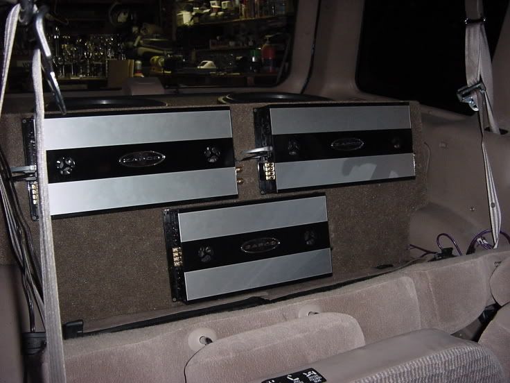

also ive been thinking of places to mount th amps and i was thingkin on top of the box to mount the goliath, but since it glows i dont know about doing that, might say steal me all over it and it would be easy to see in daylight, so i wasthinkinhg of doing it like this with just the goliath mounted, and putting the 8002 in the compart ment in the floor, because its big and isnt closed off and i can put fans if i need to, this is where all my ugle wiring is going
