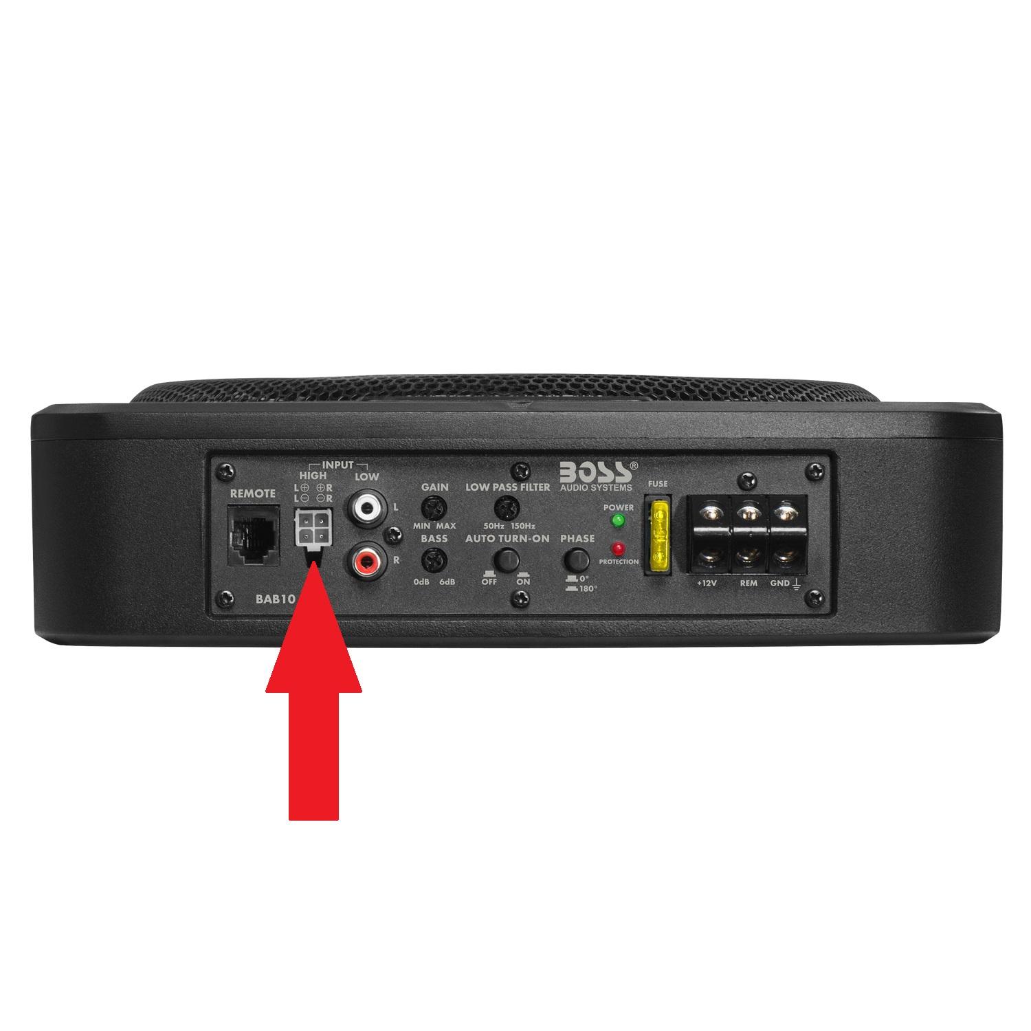

The Boss subwoofer has a High Level Input / auto turn on which you connect to the trucks speaker wiring (I'll add a photo with an arrow pointing to the high level input, they usually come with the small harness), which may work fine for this sub. Hard to say though, but, the Kicker LOC would likely work okay otherwise, or in the event the high input on the amp doesn't work well.
