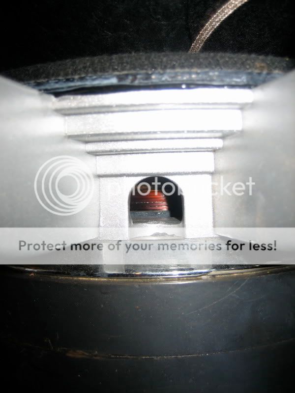

After that I didnt have any problems with the sub, the thing was in mint condition when I sent it to him, and since he didnt post the pics I will, the subs tensil leads hadnt even worn a good grove in the felt pads on the cone and they never even touched the spider at all, but the supensions loose???? I also noticed you said on the first page the sub was sideways in the box when it arrived, why didnt you say anything about that when we were texting on the phone before you made this thread

just curious, does the sub make the scratching noise when you push it or when it plays and can i get a vid of it playing (or not) n pics of the coils, dont get me confused bro, im not saying its your fault for the terminals or the sub getting blown, but I trully belive your lying about HOW you blew the sub be it the equipment or the amount of time played or you actually having it at 2 ohms instead of .5.
