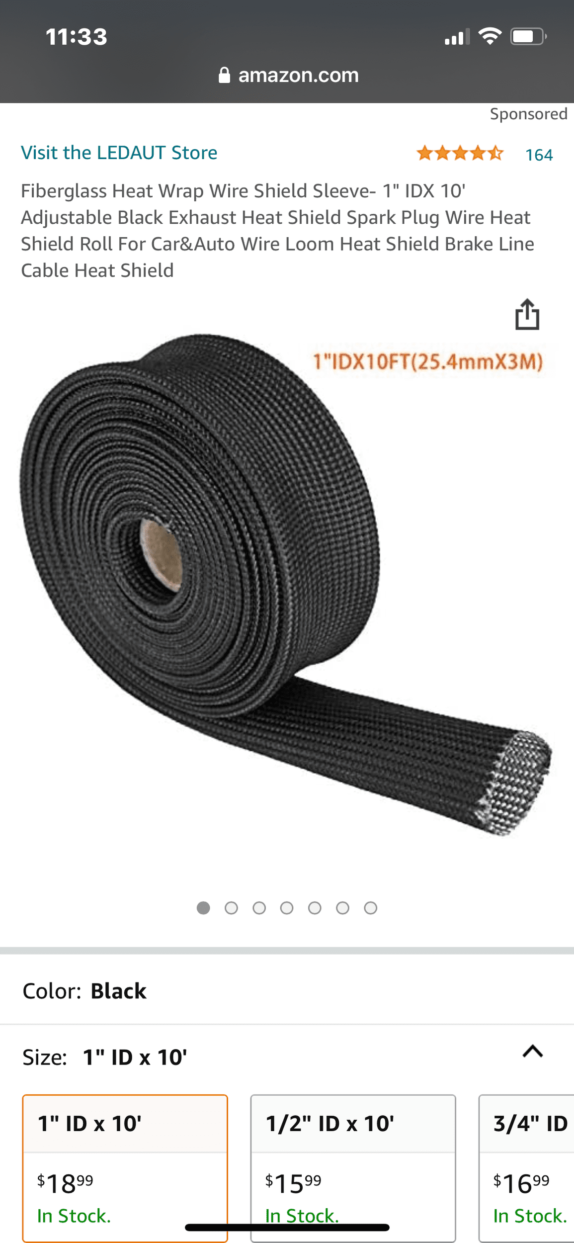

You are headed in the right direction. I used Heat Hose Fiberglass Wrap Shield Sleeve.
Good stuff.

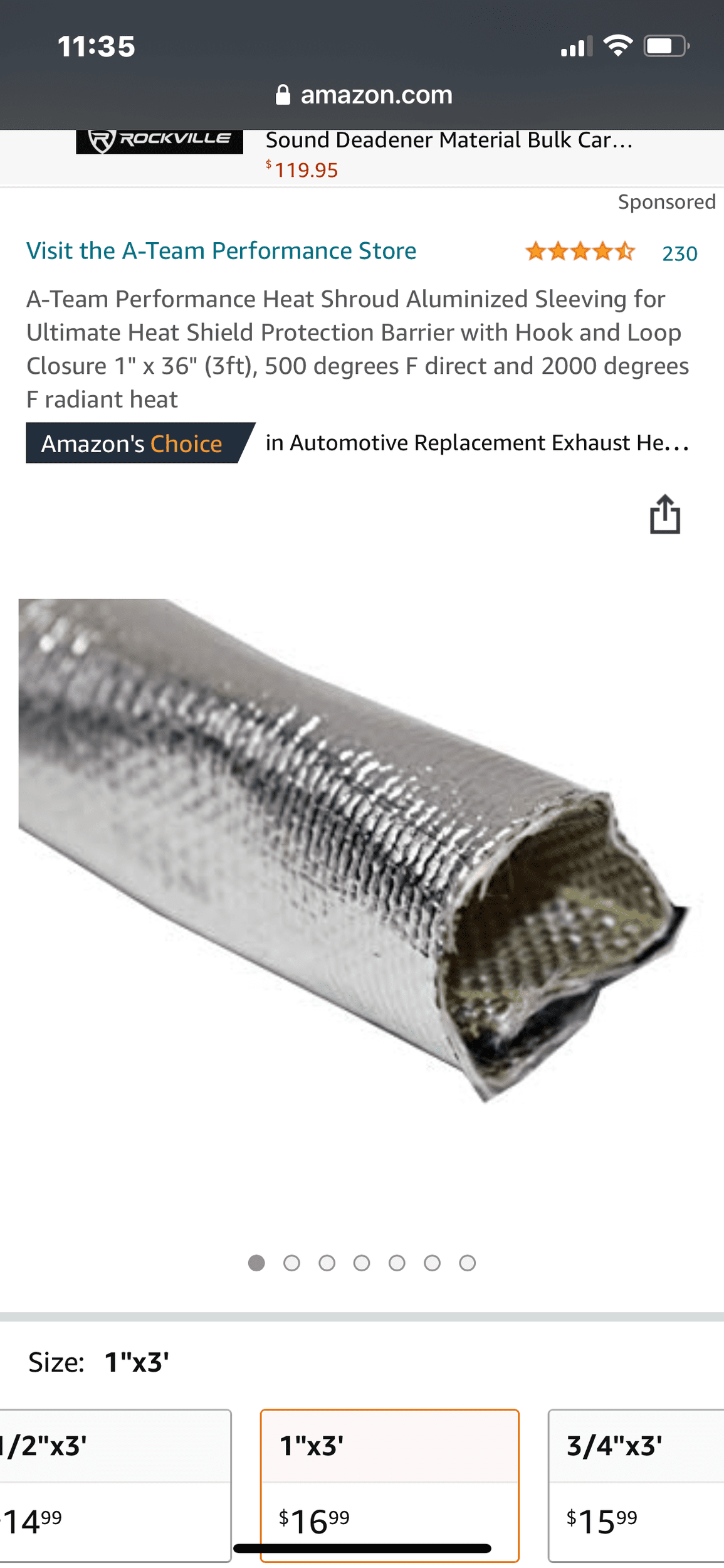

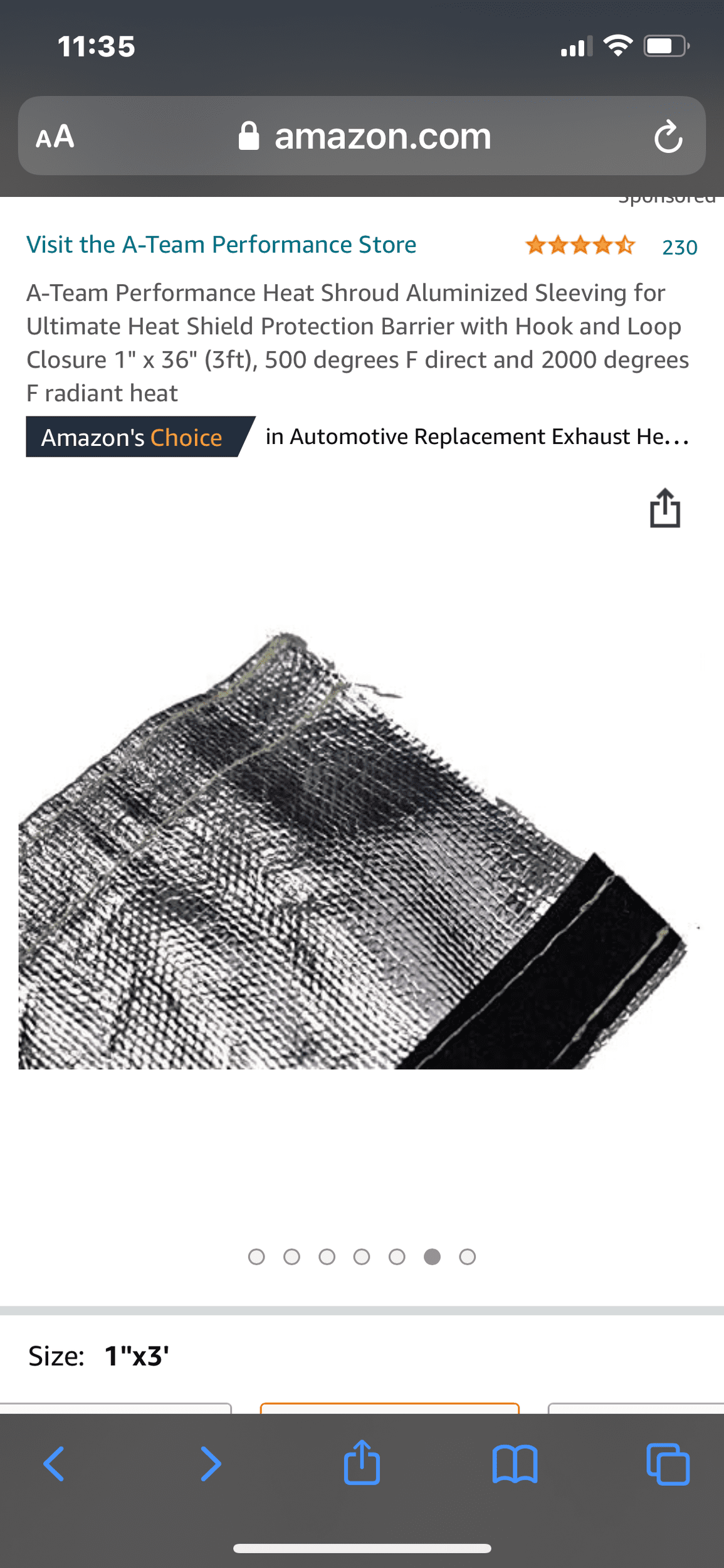

This is what I am looking at. The black stuff may not work, as I have already run the wires and do Not want to pull them back out. It looks like the other option wraps around. And for appearance, I may see about shooting it with matte black rust oleum stove paint.

I also used the wrap-around type.
I ordered tesa tape and the A-team heat shroud stuff for areas closest to the exhaust. Also ordered the little tree pin things with zip ties attached to tidy everything up near the firewall. Hoping to be able to drill a few holes in the plastic plate near the crease of the hood in the rear to plug them in and wrap the loom. It’s been a long project, but it will pay off in the end.
