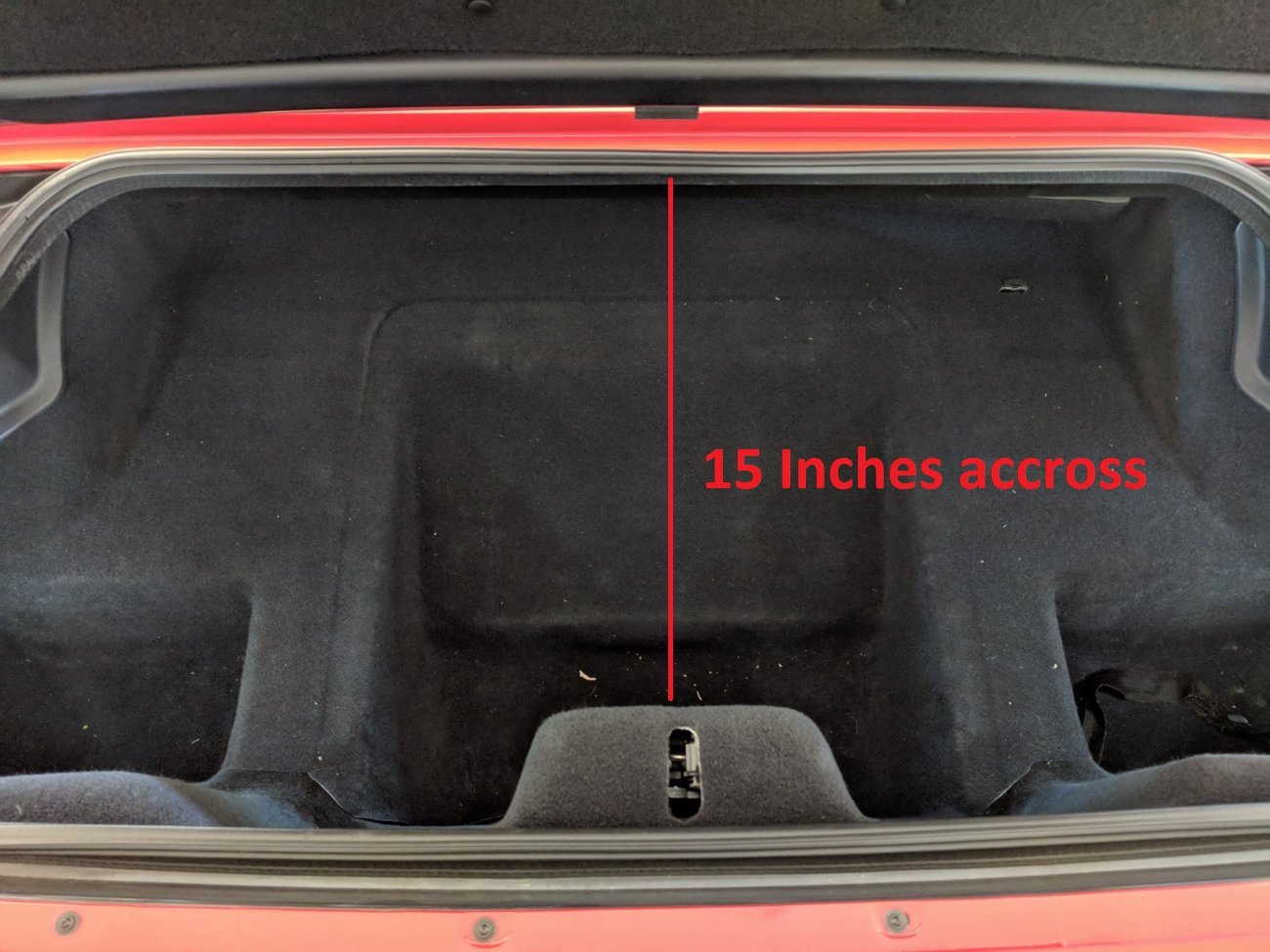

The box cross section for the trunk is only 15" for a box to fit inside before it can be pushed forward to the partition. Any box deeper than that won't go down inside the trunk to slide it forward.
Once the box is down inside the trunk, it has to slide under the trunk lid lip, then forward to behind the seats. The max height here is 15" inches also just like the trunks cross section

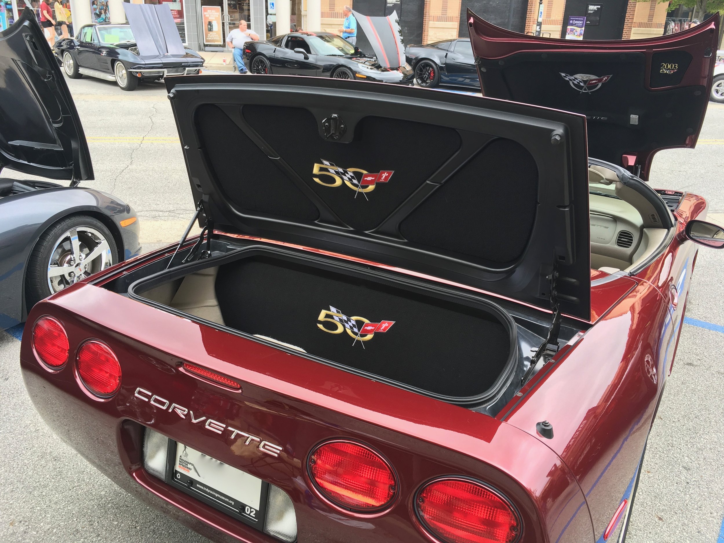

37717
The box then stays hidden under the trunk lid's partition.

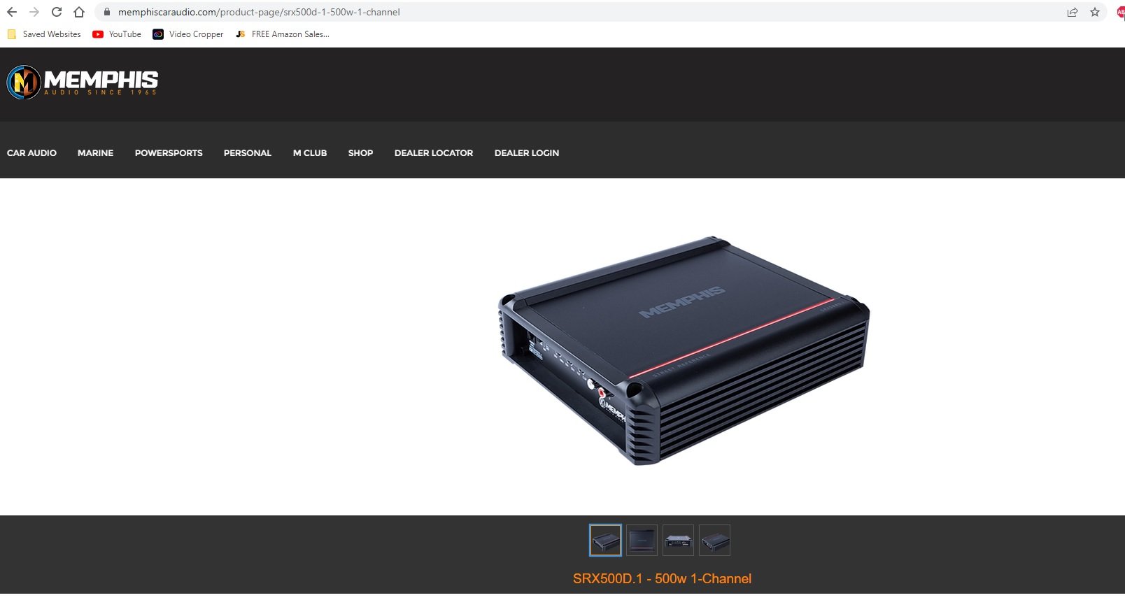

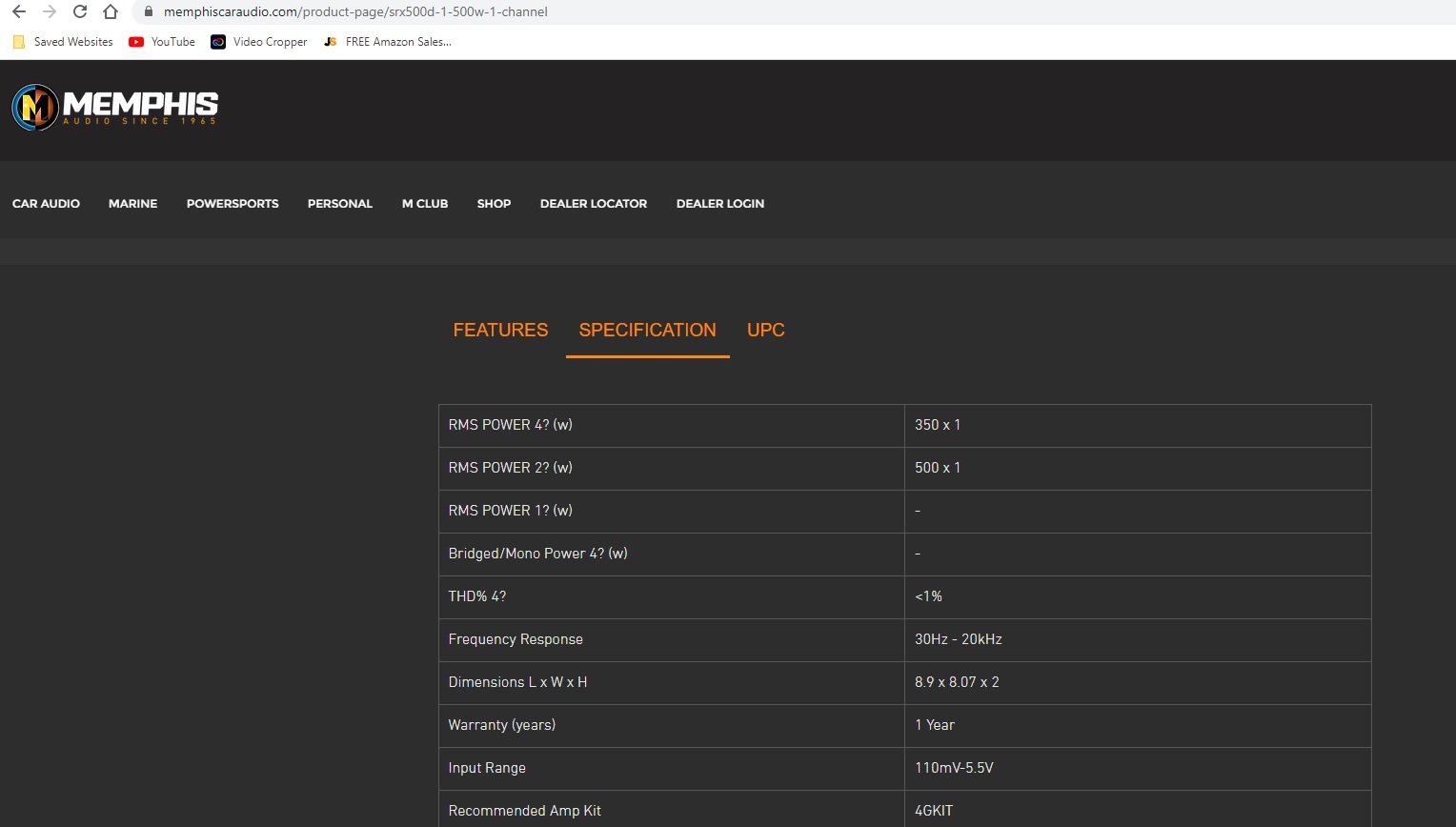

This is the amp aswell as the specs.

You have plenty of room to get a pair of 10s in there ported or Aero-ported
Wire to a final 2 Ohm load for that amp and should be fine. Look in Box Design section and see if Buck can get you a properly tuned enclosure design.
