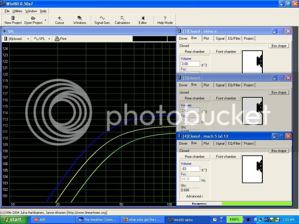

shiva-x(blue) VS. Dayton hf(yellow) VS. Mach5 ixl 12.2(green)
all were models up at a .688 qtc, and all were set at 500 watts input power.
the shiva-x looks like the way to go, with the dayton hf in second. the ixl models up a little strange, it requires a very small box to get the same response as the others, but it also wants a lot of power to get loud. the only thing that scares me about the dayton hf is the low x-max. i think i'd be pushing it to hard down low.
out of those 3 the shiva is the way to go.
