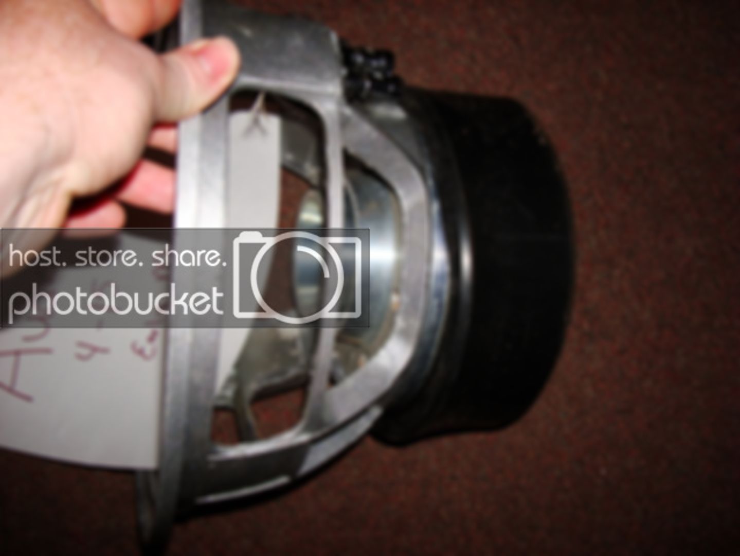

what sub is this?
right side is a different motor than on my 9102?, and way different from my 88120Ti lol.

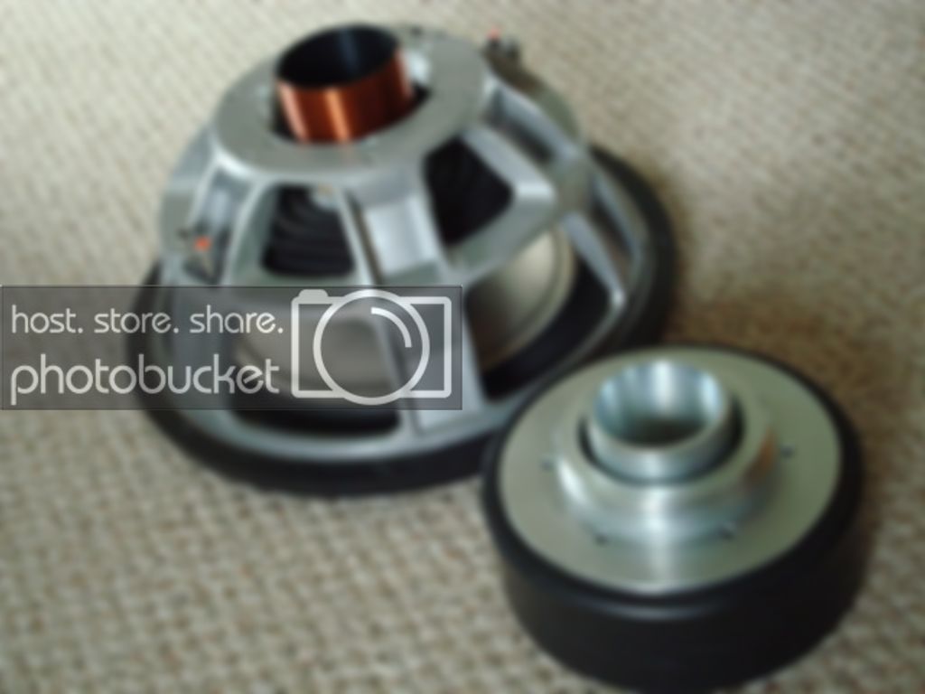

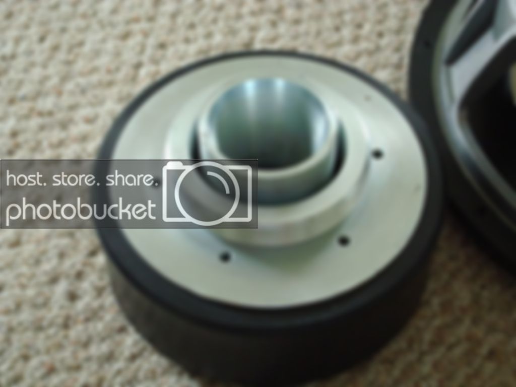

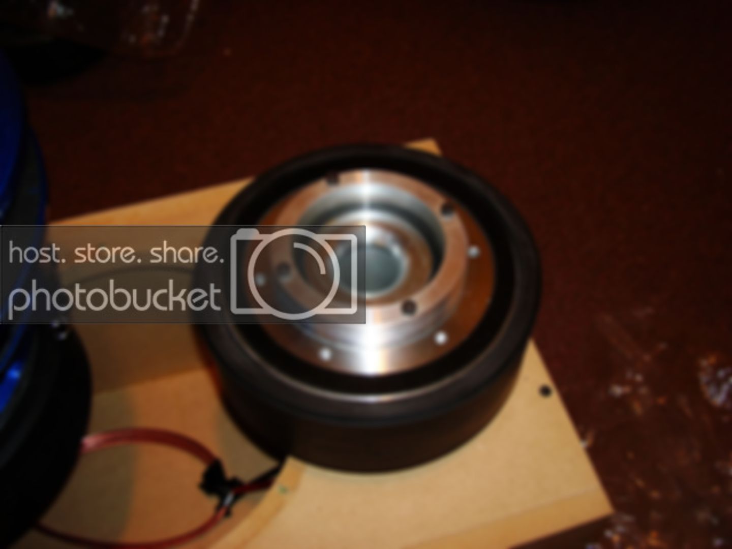

Yeah the 88120Ti doesn't have threads cut into the top plate for a QCA, just a tapered top plate with a gap height measuring 35mm. Same gap height between the two versions.
Snap a picture of the motor on your 9102, let's see if it's a TC9. A 9102 top assembly will mount up to a TC9 with a threaded ring but it won't be linear at all due to the center of the coil sitting at the wrong height in relation to the center of flux in the gap. They're not interchangeable.

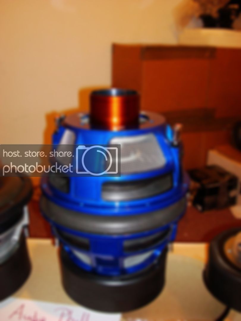

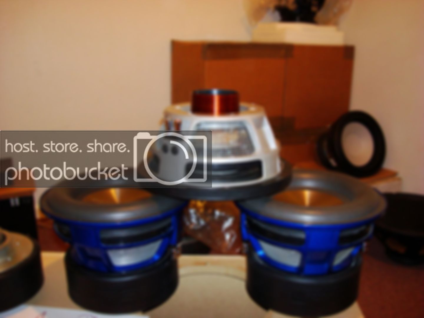

This is my 9152 with the same motor. Also the same driver in the OP.
