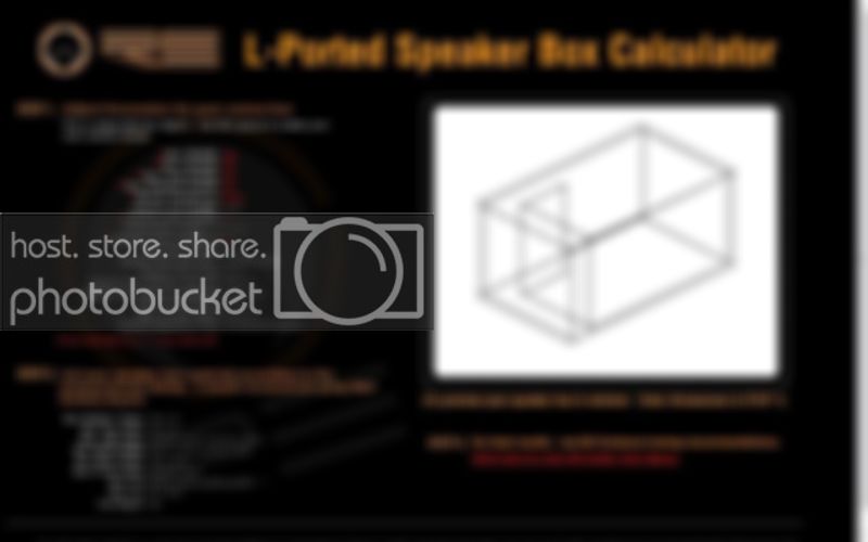

going the re way for now since i dont have any responses yet.
do these re calculations look right?

what lengths and height should the slot be? depends on whic hway its facing. back up et cetera. subtract 1.5 from that sides length.you'll want 25-40 sq in of port area. depending on the sub your using. example with that box if you were going to have port facing rear. the port would be 12.5 tall x 2~3.5wide.the length will then vary based on whaat size the port is.
(does the enitre slot port area also count as displacement? my above net volume is assuming its a sealed. idk if the port would also take away?)
yes the ports displacement must also be taken into account. if youd like some more help with this id be more than glad to help you via pm. or i can do you a design with 3D sketch for a small fee.
