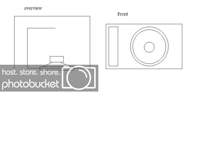

Junior Member
Hey, i have a Power Acoustik Mofo 152X who need a box. I will build a wented box for it.
The subwoofer should have 3,4 cu.ft and they are stated with 2 x 4" port on 10" length each. But i will have a slot port, also a square port.
Can someone help me to find out what size the port should have?

A sketch of the box i think:
So your box is 3.4cu/ft? My guess is around 45-50sq inches of port opening for 3.4-3.5cu/ft of air space. Although I have heard that Power Acoustik speakers like big boxes, so you could possibly go bigger than that. Length will be dependent on tuning preference.
