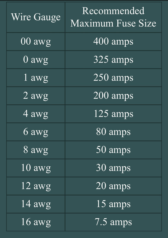

Technically it should be fused by the battery, and you fuse wire based on its size. I’ll admit my alt to battery run isn’t fused, but I do highly recommend it for safety.
If the wire rubs / short, or you get into a collision and it gets pinched, it’s a fire hazard. Any wire that connects to the battery, which is a very high current source, is supposed to be fused close to the battery.
Here’s a good chart from a solid source. Wire / recommend fuse sizes from bcae1.

Fuse anything going to the battery 150amp fuse I would do. if it shorts you saved your battery, and than you look for causes why it happen, if nothing happened, than your good. Altho big 3 with a 120amp alternator to me is pointless your electrical in the car alone should support that load. Placing a fuse on a 120amp alternator needs to be around what the alternator puts out, a 200-250 amp fuse is point less it'll never pop unless a major surge in power at that point it's to late the fuse never popped the whole purpose of fusing is to save your gear !!
