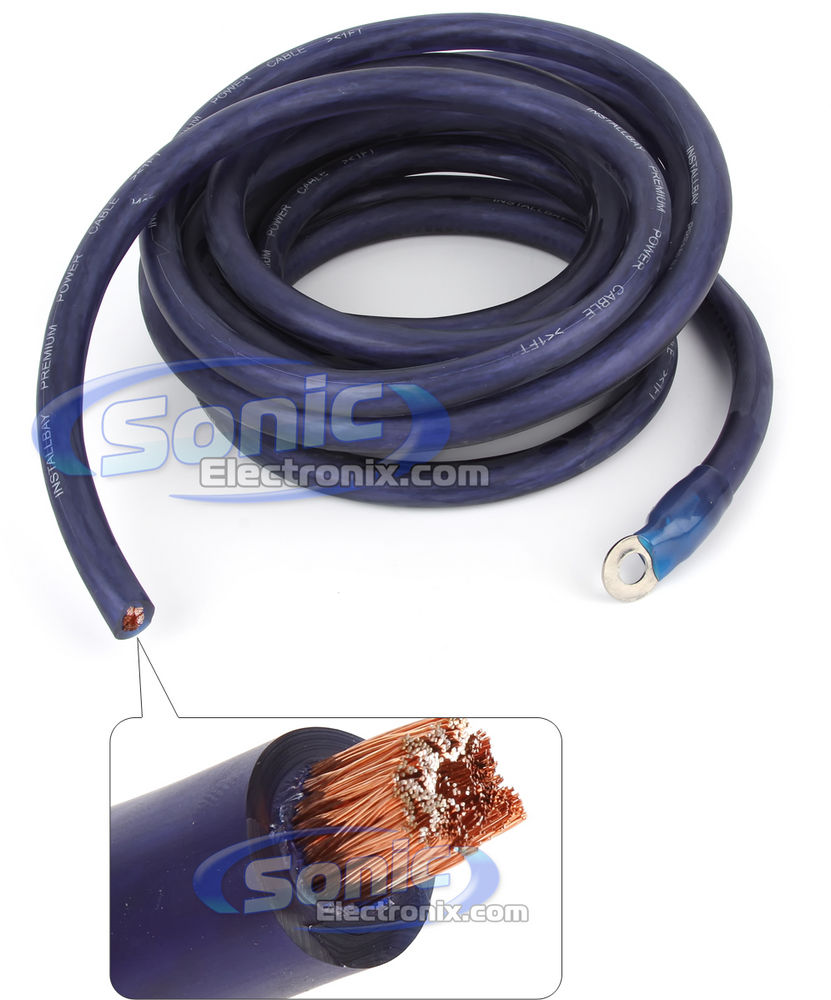

yeah that kit is garbage my friend. Look at it when you get it and take a picture of the actual copper
If that's true, I spent $37 for some fuses, distro blocks, speaker wire and RCA cables(which if you're right, I wouldn't trust the RCA anyway)
My Knukonceptz is thicker than this garbage :
Get a refund, and find better quality.
