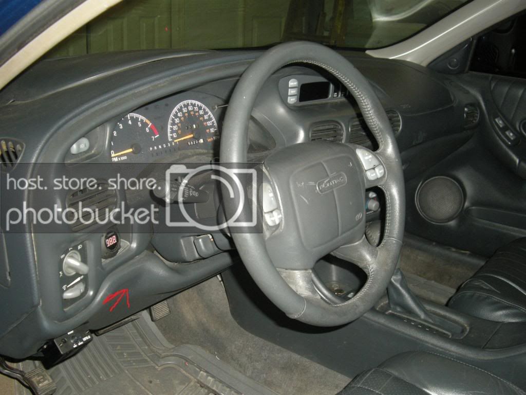

where do you guys normally mount the knob at?? I would like mine to be unnoticable

here is a pic under the red arrow. was showing another gp owner where to pull on the dash to remove it. i liked this spot.
