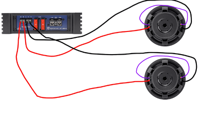

diddlebrittle CarAudio.com Newbie 17 1 Idaho Jul 15, 2024 #1 Would I need to buy 2 ohm or 4 ohm subs to make this 2 ohms load to the amp if wired it like this thanks! Click to read more... Attachments Artboard 1.png 143.2 KB · Views: 82
1 1aespinoza Premium Member Junior Member 4,511 1,875 Pharr, Texas Jul 15, 2024 #2 diddlebrittle said: Would I need to buy 2 ohm or 4 ohm subs to make this 2 ohms load to the amp if wired it like this thanks! Click to expand... 2 Ohms. Last edited: Jul 15, 2024 1
Deiimos CarAudio.com Veteran 577 391 Columbus Ohio Jul 15, 2024 #3 Yeah 2 ohm DVC (dual voice coil). Although looks like your diagram shows all coils parallel which you would not do to achieve 2 ohm. Instead wire each DVC sub in series in the box, then parallel at the amp for 2-ohm. 1

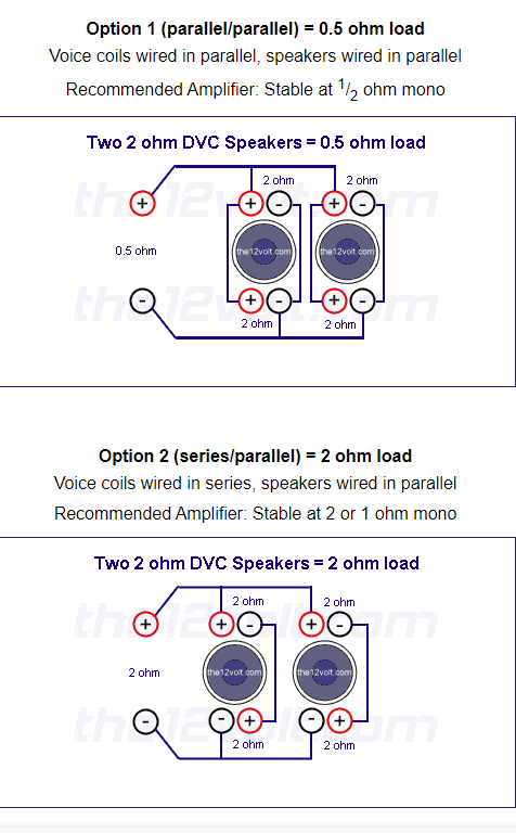

Doxquzme Premium Member Current build, 2012 Mazda 3 Hatch 2.5T 2,951 1,494 Boise, ID Jul 15, 2024 #4 Here are y our wiring options with dual 2 ohm voice coils. 1

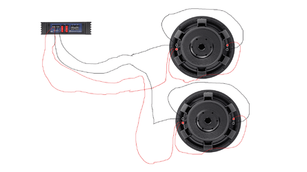

OP diddlebrittle CarAudio.com Newbie 17 1 Idaho Jul 15, 2024 Thread Starter #5 So if im understanding this I need to buy 2 of 2ohm subs and wire them like this to have a 2 ohm load at the amp Attachments Subs.png 162.2 KB · Views: 67
Doxquzme Premium Member Current build, 2012 Mazda 3 Hatch 2.5T 2,951 1,494 Boise, ID Jul 15, 2024 #6 2, dual 2 ohm voice coil subs wired like this So yes, that is the same as your drawing. Last edited: Jul 15, 2024
