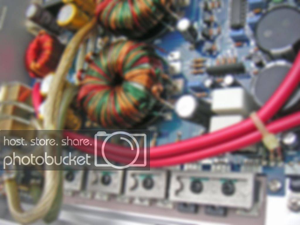

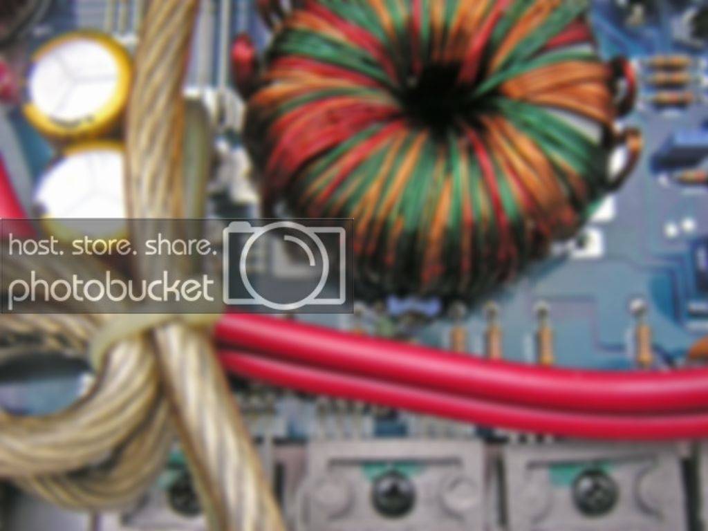

when I got this hifonics bx 1605d it had the little blue rectangle thing near both multi color wire blobs looking burned. the amp still functions ... so go figure
but id like to know what function is being messed with having those two littel guys burned up on the board ya know ?
have a look at some pix.
this green arrow is pointing to the thing thats charred up
same thing on the other side but harder to photograph due to those wires

those blue things are metal film capacitors.
your amp to me looks like it has some blown power supply transistors. in pic 2 you can see the darkened legs of one of the transistors.
amps sometimes will still work as long as the bad transistor is not shorted to the gate and has burnt the contact between hot and ground.. the amp will work. but output will be diminished.
