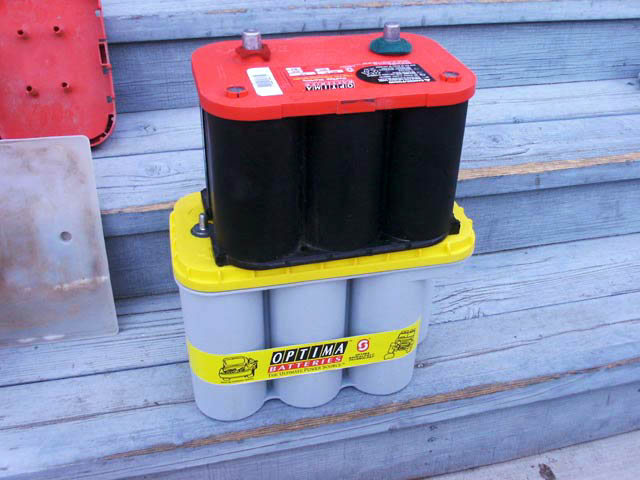

grp 34 sitting on top of a grp 31( i decided to google it myself after i had asked )

Well i did some measure under the hood. The largest batteries i can fit in each spot is 8x8x13 If the battery is shorter i can go a bit wider. Looks like i will be able to fit some of the grp 31 batts under there if needed with some massaging.
