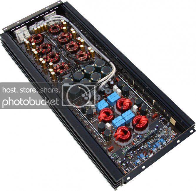

what do you think about these amp guts?
i thought it goes like this 14.4 volts x 90 amps = 12961296 x .7 (70% efficient amp) = 907.2 watts
but i may be wrong. i don't claim to be an electronics engineer like most google kids. I would assume that the design of the power rail n stuff would effect that. Like Rockfords power boost rail line, i would assume has a different output than the fuse suggests.
I just go by CEA ratings and keep it simple.
It's basic stuff that you learn in highschool. Volts x Amps = watts
Anyways, I was referring to the 80 amp fuse of the first amp.
I was just stating my opinion it does 1200 at 14.4 so shave off at least 100 because you will not be at that voltage in most cases. I go by fuse on cheaper amps because I don't trust them to rate well at all. I know fuse ratings don't mean very much but they have a decent amount of meaning. The mmats 3000.1 puts out 3k and only has a 100amp fuse.
Fuse rating can be inflated. That's the only reason people say it doesn't matter. But most of the time they are fused properly..
And yea people obviously you can't tell where the builder of the amp buys his coffee by looking at the fuse rating but it is a huge indicator of what class the amp lands in
either way my opinion stands and if there is a large price increase for the 1200 I would just snag the other amp. I still bet that the 900 watt amp will get hot as **** but they look stout.
I was basically agreeing with ya
the price difference is minimal.
the brand is a norwegian brand called lib
they also have a 5kw and 7kw amp
in my eyes it looks like a zenon board

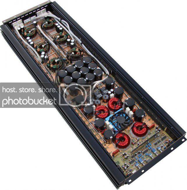

here is the 5kw
and here is the 7kw
cheap for us here in norway. it is about 380 us dollars
but remember my 500w cerwin vega amp was about 666 us dollars
car audio is 4x as expencive here compared to in the us
the price difference is minimal. the brand is a norwegian brand called lib
here is the 5kw
and here is the 7kw
WOW! Those are Fantastic Looking boards man!Several Huge Caps, and Nice coils, and that feed is Pretty good sized.How much for those in US $??Ill bet shipping will Kill a man:p:
Actual real life is not something you can predict with a formula. Amps have a certain "headroom" built into them, in the form of capacitance -depending on the design. An amp with a good bank of capacitors can supply a more steady burst of current for a longer amount of time - without having to draw more current from its source (12V). Forget what you read on this forum about capacitors, most people are idiots. //content.invisioncic.com/y282845/emoticons/wink.gif.608e3ea05f1a9f98611af0861652f8fb.gif
Audio amps, by their very nature take a low voltage high current supply, and turn it into a medium voltage, relatively low current AC output. It doesn't represent what it is being fed in the least bit...... Judging a power supply by what fuses it may have on the DC side does not equate to what it will put out on the speaker (AC) side. //content.invisioncic.com/y282845/emoticons/wink.gif.608e3ea05f1a9f98611af0861652f8fb.gif This is why a lot of cheater amps can have fuse ratings much lower than the monster ratings we see on amps today...
eh..heard of? yeah..... so are you telling me there is people running 10kwrms fused at 80 amps? Or whats going on..'cause if thats the case then I was totally wrong
MECA's a special case, they set their classes by fuse size. So of course, the competition becomes who can stretch the fuse ratings to the absolute limits //content.invisioncic.com/y282845/emoticons/smile.gif.1ebc41e1811405b213edfc4622c41e27.gif Sort of like USACi and "2 watt" amplifiers that do 10kW //content.invisioncic.com/y282845/emoticons/tongue.gif.6130eb82179565f6db8d26d6001dcd24.gif
Not exactly a situation for the non-competitive install...
