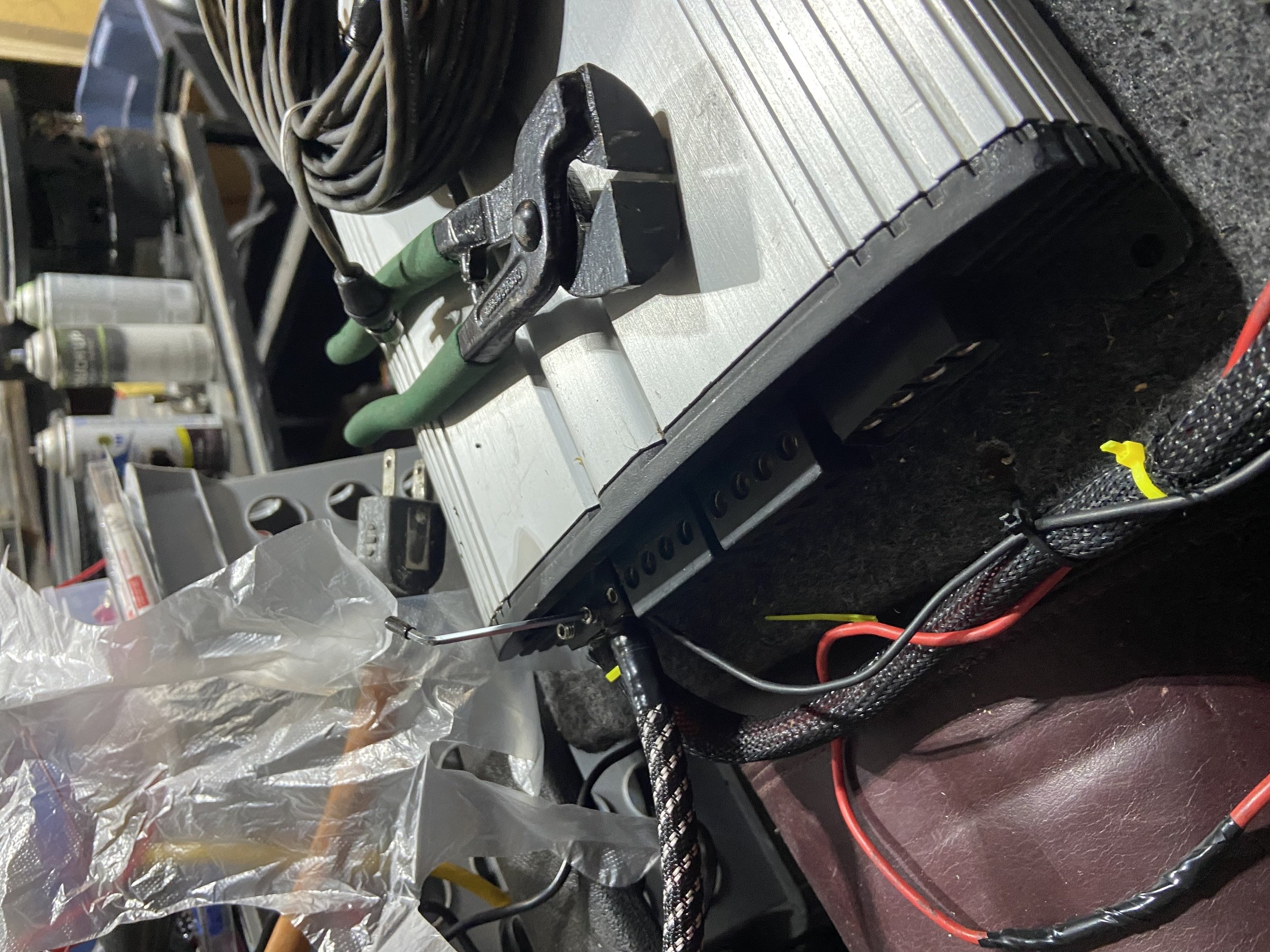

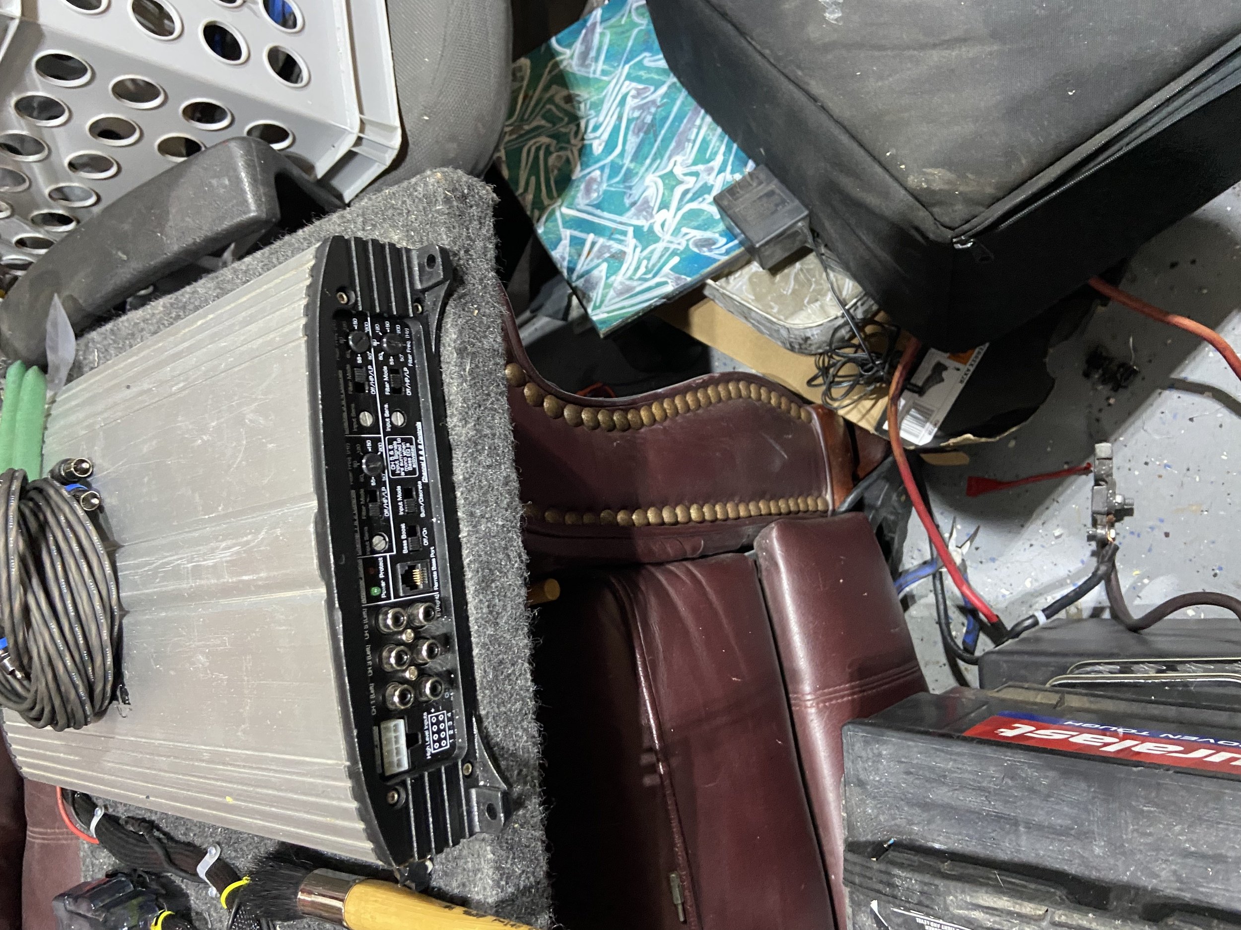

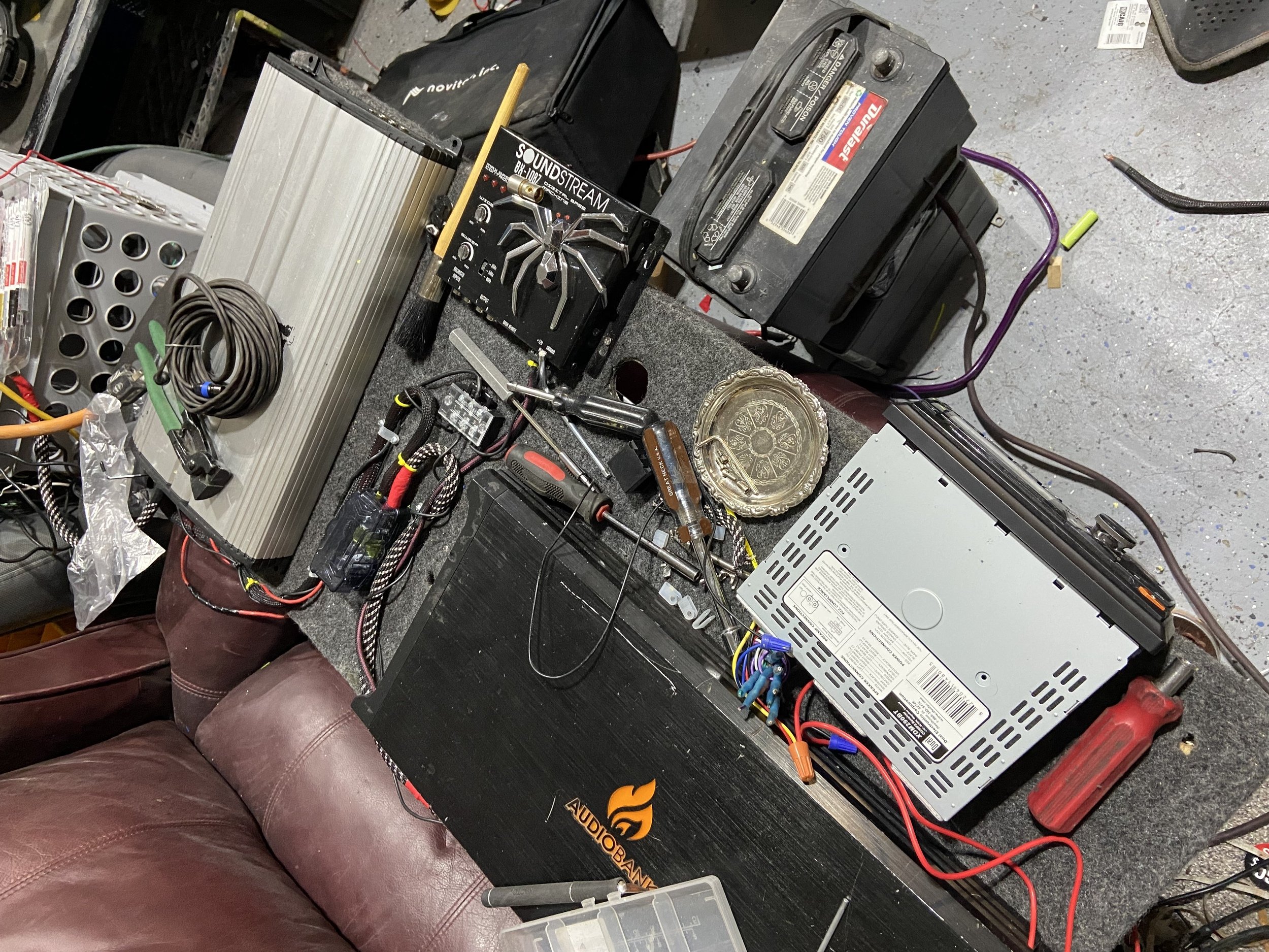

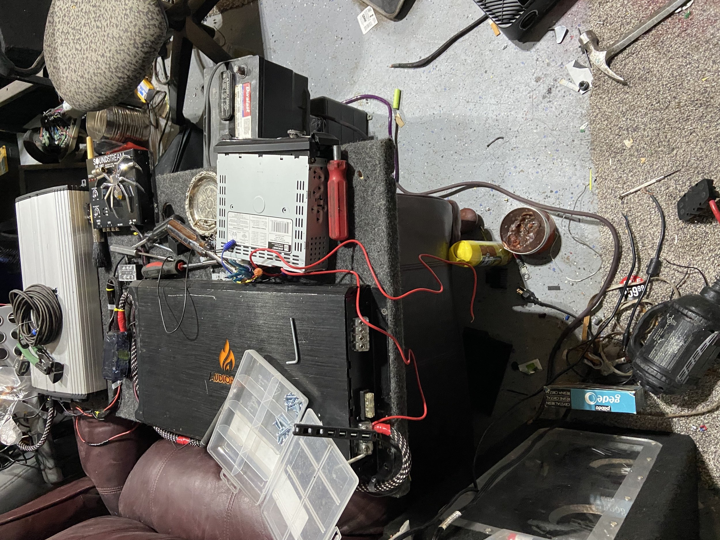

Added pics of the sub there in the garage as I’m working on the wiring sub are in the truck but to cold to go outside at the moment

The settings on channels 1&2 are good, plus the input sum is activated. You should be able to connect one set of RCA wires into 1&2 and get signal to all speakers. If this does work, then input RCAs are ok.

thank u guys for all the help got all 6 channels to work
