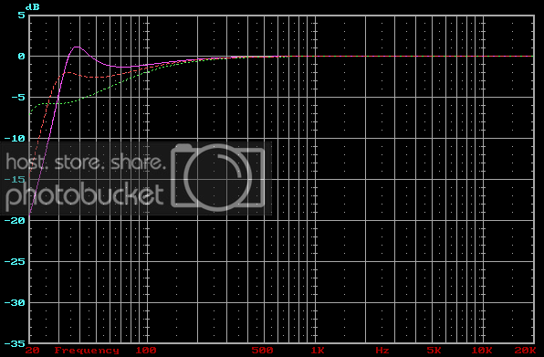

for an RL-p 12
Ported
solid pink=1.5 @34
dashed oragnge=1.5 @28
dashed green=2 @30

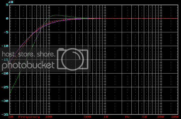

Sealed
Solid pink=1.15 cubes
dashed orange=.86
dashed green=.2
