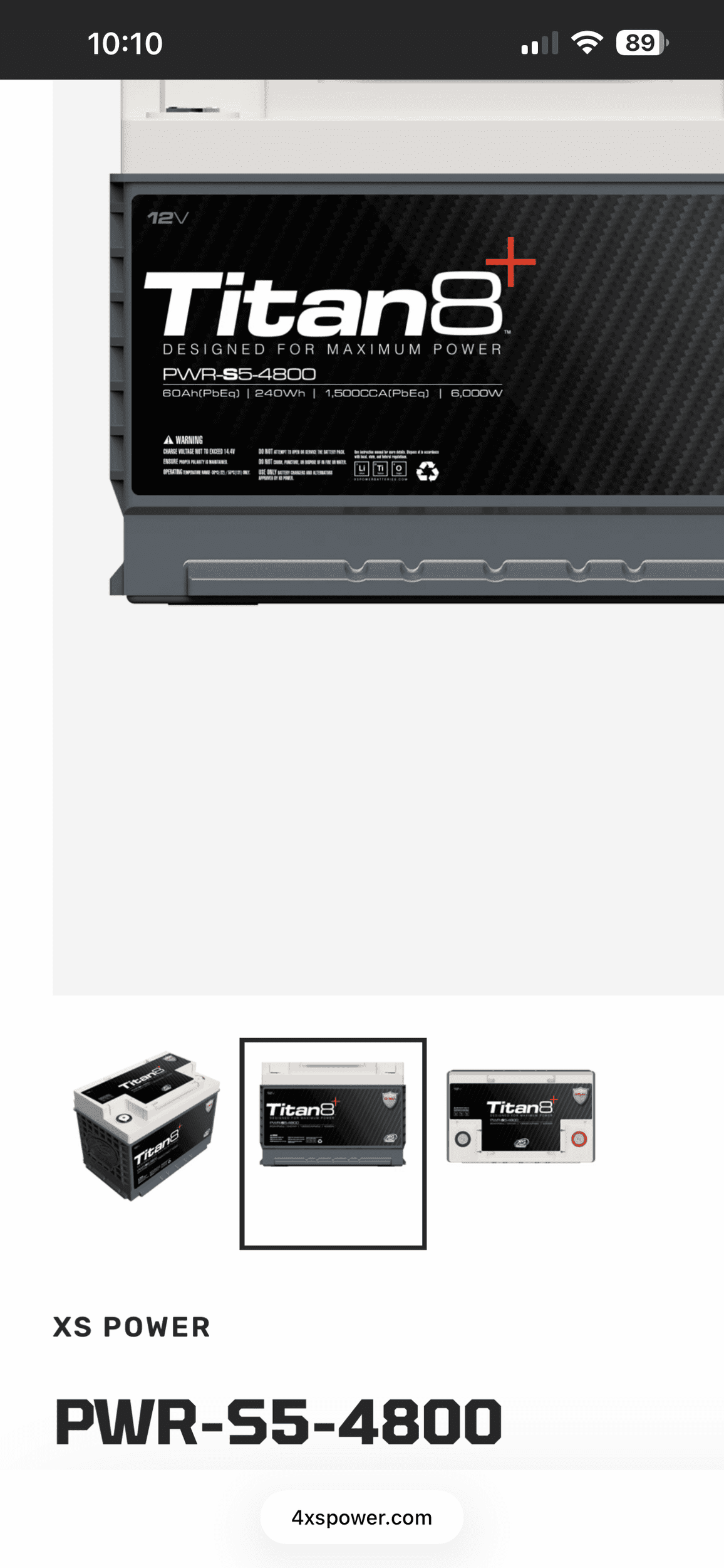

I was thinking about this one I just don’t know about lithium

Urban legend, non-issue, at least any longer.
The Titan 8 uses lithium-titanate cells and is very safe. The GloweVoltage uses LifeP04 technology, both are every bit as safe as your under-the-hood AGM or yellow top.
You don't put lithium in the engine compartment; that's the only thing you can't do.
I've run both the Titans and currently run a Glowe series 1, in Boise, not too far south from y'all, and HOTTER in the summer than CA for sure.
The Lithium would be mounted inside the car somewhere, and when it's hot out, your air conditioning is on, and when it's cold, you run the heat, always a pretty temperate environment.
And because the charging voltage is relatively identical, no DC/DC or isolator is required. I do have a 500A smart isolator inline, just because it allows me to disengage the front end when I want to work on the back, etc.
I have close to 5k on tap and still use the 110A alternator - never so much as a hiccup.

That’s good info but that’s kind of hard to locate a battery inside my car would the trunk work? And currently I’m running a 3,000 watt taramp for my kickers L7’s 3,000 watt prv for mid range speaker and a 400 watt taramp for tweeters
