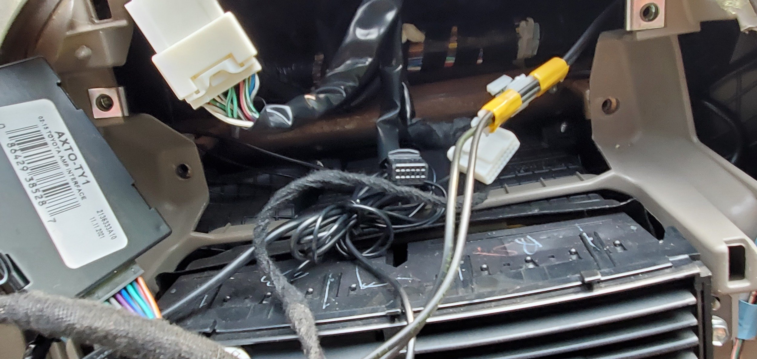

What are these connectors called?

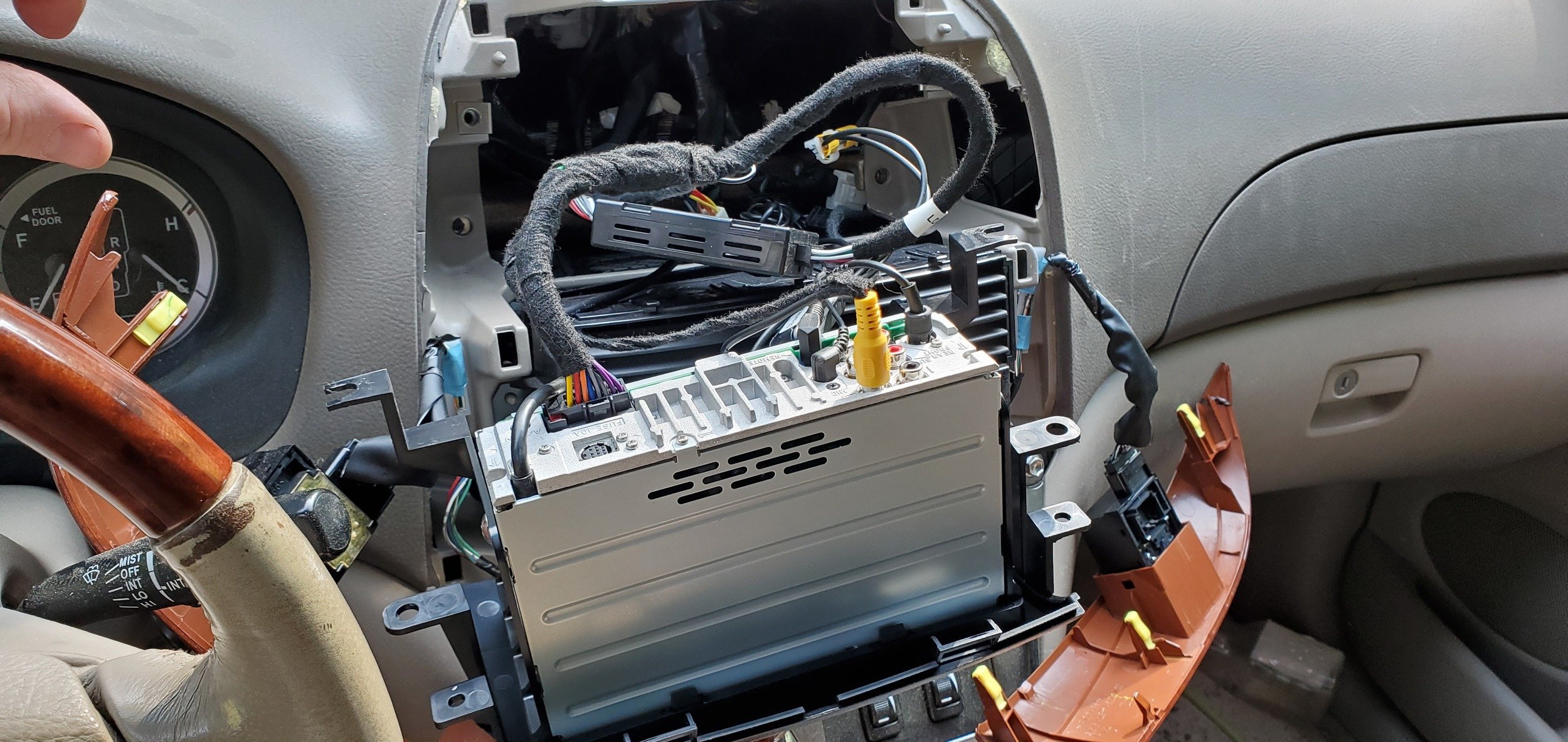

Ok, I finally got a chance to take the Sony radio out. The situation back there is *far* scarier than what I have in the Rav4.

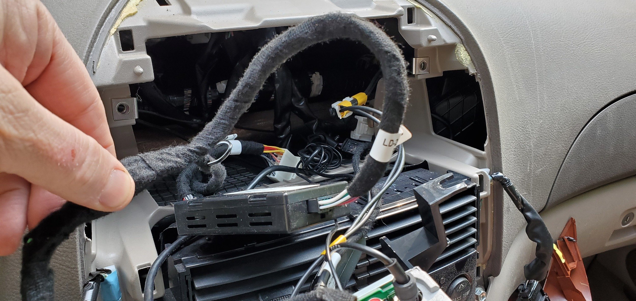

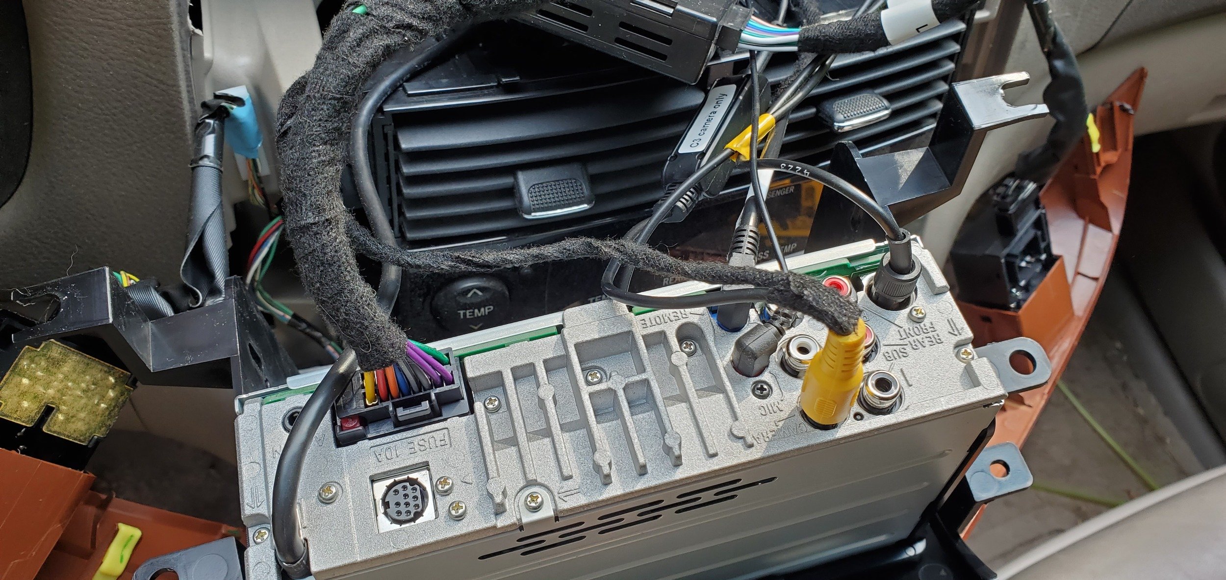

Doesnt look like the OEM wire that goes to the back of the radio has been disturbed looking at all that neat tape. You just need a connector that connects to the factory connector and splice the wires off of that onto the wiring harness of the new radio. Looks like you have the antenna and mic plugged in. I don’t know what the remote wire is connected to. The yellow wire to like a back up camera or dash cam
