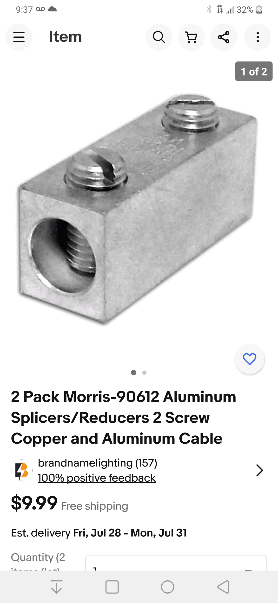

You could just run both wires into one 6 or 4 AWG splicing reducer.
