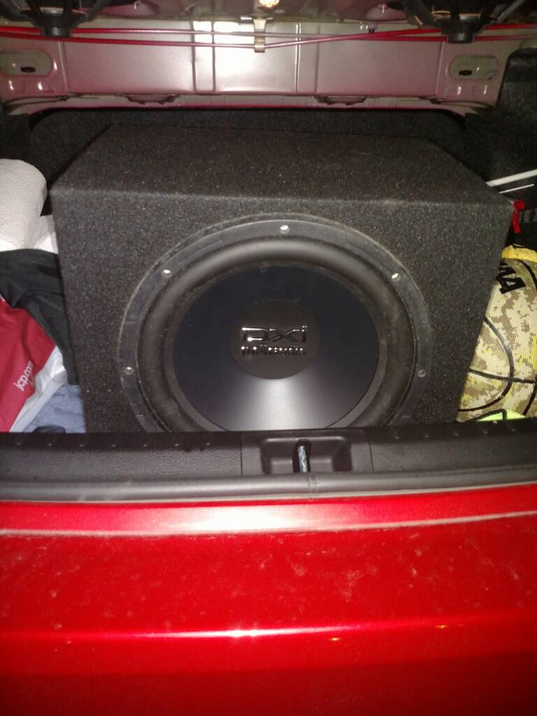

This guy I work with knows I'm in the market for a sub and said he has one laying around but it has no amp. It says DXI PolkAudio on it. It's in good shape but I have no idea what the specs are and was just wondering if this amp would be good enough for it.

Before we can advise you that we need to know what sub that is. Unscrew it from the box and look for any identifying information. if there's a model number or anything you can read let us know , otherwise just take a bunch of pics. that way we might be able to recognize it or find it online.

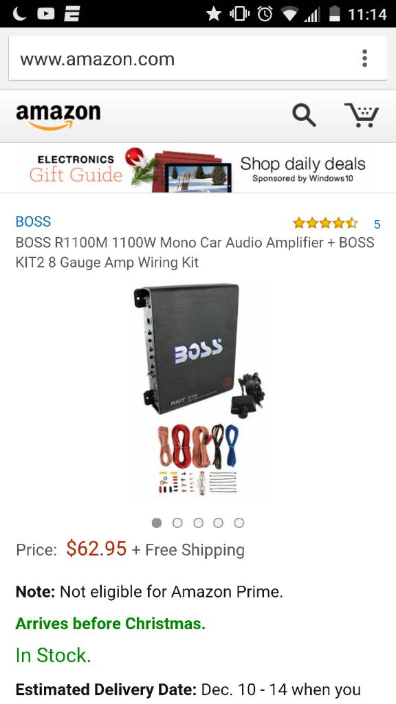

Boss is widely considered a ****-tier brand around here, but if you're just getting your feet wet it might be sufficient. Once we id the sub we can probably find you something much better for not too much more if you dont mind buying used

That could be it, but it couldn't hurt to see the rest of the sub for comparison.
If you don't already have one, get a multimeter. You could probably find a decent one on Amazon for $20, or you could get an acceptable one for under $10 at harbor freight or radio shack. This will help you determine the impedance of the sub's coil(s), help you ensure you have then wired properly if it's dual voice coil, and help you set the gain on the amp.
If you do go with that boss, or anything with a remote bass knob - don't use it. It changes the gain on the fly and you'll most likely clip the sub to death (you'll learn about that later). Same with the "bass boost" knob. Don't use it for the same reason
If the sub pictured is the one you linked then that amp might be a good fit. The boss supposedly does 413W RMS @ 4. That sub is a 4 ohm svc sub rated (I think it said) 350 or so. The apps probably overrated and with the gain set correctly you should be fine.
