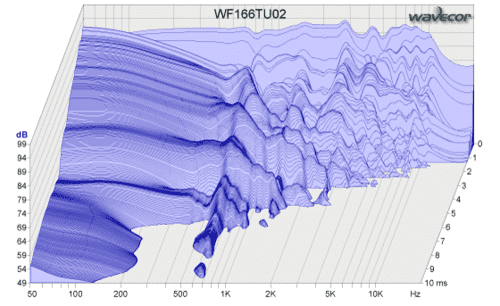

Waterfall plot expresses the decay of energy across time (ms) and frequency . The quicker the decay, cleaner the driver. Any peaks that do not die off as quickly are usually a resonance of some sort, stored energy in the cone or a cavity resonance. Things like that.
This is what the plots normally look like. You can see that this particular driver has some energy storage around 600-700Hz.
Your noise floor looks high in the plot so, kinda hard to tell.
