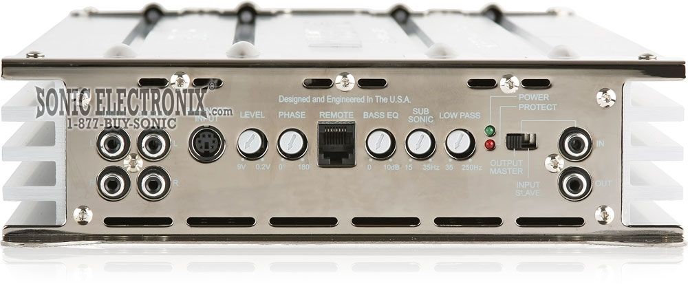

Heres the controls Im working with

what is your gain set to? do your fronts get too loud before the sub reaches a good volume? how did you go about setting it?

maybe a gain issue, are you also running an amp on your front speakers? where does your volume control end up when the speakers are too loud? if you post what you have your amps settings at that will help a lot.
maybe a gain issue, are you also running an amp on your front speakers? where does your volume control end up when the speakers are too loud? if you post what you have your amps settings at that will help a lot too.
Not currently but will be soon when my components get here... Im not realy sure what they are at now since I have messed with them so much I think I just left them mostly all at about half sense it hadnt changed anything... and the volume is usualy at about 18/19 on my deck so that its comfortable but Ive turned it up to like 22 and the sub was louder but still not very loud... however at that volume my speakers where much to bright and loud
