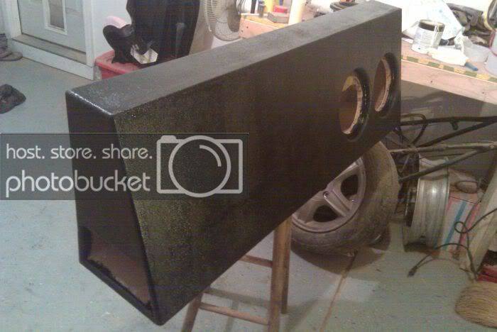

U gotta remember most guys at audio shops are morons. Most just because they have never heard of high end audio. Also many build shitty boxes and give shitty advice. I think like said you would be fine. Do the big 3, then like also said maybe get a small extra batt in the trunk. And yea if a box is designed shitty you will hear the port noise. I just built a box in a reg cab s10 for 2 re 8's port to the passenger side(thats what the guy wanted) no port noise and it slams.
port noise my asss... that port is square and not rounded off. i highly doubt you'll not hear any port noise with that box. especially a regular cab s-10. why didn't you build him a sealed down-fire box? that to me would've been a lot better
