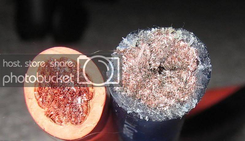

^^^pic by ultimate157^^^
Welding 1/0 on the Left.....Hyperflex on the right.....Enough said.
Do me a favor take that hyperflex and cut that bad end away so that its a clean cut like that of the welding wire next to it.
Once again it all depends on the brand of welding wire used. The 1/0 wire i use is automotive cable but its pure un-tinned copper. The outside jacket is much thinner then what is pictured here. Still super flexable.
I get it for hella cheap. so thats allways a +
