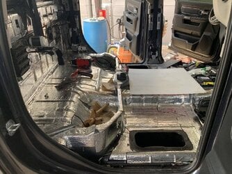

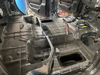

Update - fought with it all last weekend. Got the cab ripped apart, laid the butyl and foam and found out I under ordered. Oh well. I did as much as I could. That is what I get for believing the internet on sq footage.
I ran my power wires under the truck along the frame in corrugated tube taped up and zip tied to secure it well.

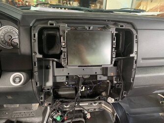

Connected the head unit with a PAC AP4-CH41. Plug and play. Drill a small hole in the bezel for the control knob and run a USB for computer tuning access. Not sure how to go about that yet really.

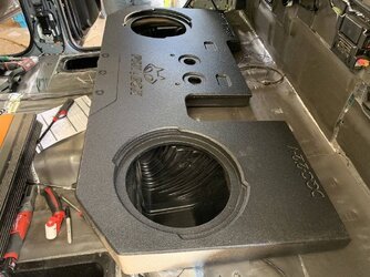

I tried to get my box in, and turns out, with the butyl and the foam, it won't fit with the spacers provided by fox. Frankly I'm not sure it would have fit without that stuff, but anyway, I'm trying to find longer bolts m12x1.75 which is a size nobody carries, and some thick square washers to use as spacers.
Might have royally screwed myself believing the internet. Cut off 3/8" from my seat hooks as it says to do everywhere online, but with the amount of lift I'm requiring, they may not latch anymore. So I may have to pull them out again and attempt to tig weld on some little tongues that help them grab. STUPID on my part. Should have tested before cutting rather than just believing what I read.

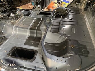

And a final note - I looked for a long time online to find pictures of a crew cab truck with everything removed and couldn't find anything. I really wanted to know how difficult it would be to cut the molded floor out and do a forward facing box. I decided against it before ripping it apart. Wish I hadn't. If you weren't scared to modify your floor pan and fab up some modified seat mounts, you could get a pretty damn big box in one of these with probably enough airspace for 4 of these subs front facing. Would take a lot of work, but to someone might be worth it.

Added 1/2" spacers on top of the spacers provided by fox and it still doesn't fit. I'm going to remove the carpet tomorrow and try again. Probably just end up going to the steel yard and getting some 2" box steel and making my own spacers. Bought longer bolts - $60 worth for these stupid oddball thread size that regular hardware stores don't carry.

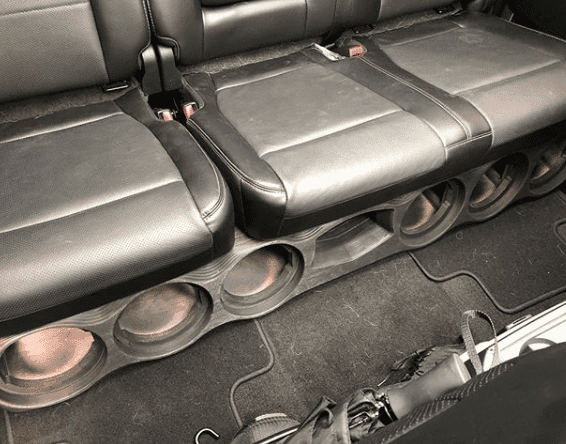

I saved a few pics of the enclosure @YukonXL04 did for his Sierra crew cab, It reminds me why I don't design underseat enclosures anymore. But really... I'm just not a Foxbox fan... especially if utilizing $400 worth of subs.
