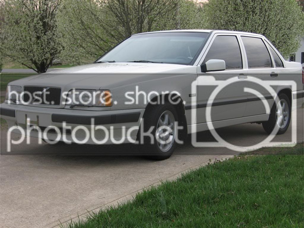

My car is 15 years old and has 261k miles on it. This picture was taken at around 235k
