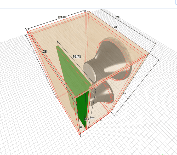

Volume and port area recommendations?
I hope that helps. My box builder was shaking his head. He didn't know what to say after I showed him your interaction with them.
Yeah I feel like it was a mistake and he meant per sub. I decided to go with 13ft3 net, 186in2, 36hz to be a little on the bandwidth side.
