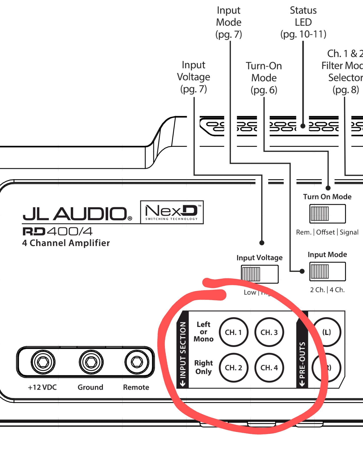

Pretty sure on those you can switch it to 2 channel mode and you only need to run rcas to channel 1&2.
Saw this on the RD line, which confused me. Seems like it is implying that inputs 1&3 are for Mono operation. Manual says 1&2, then switch selector to 2 ch.
