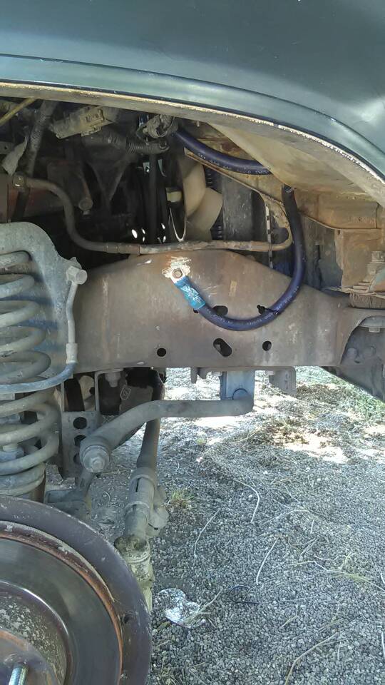

OK redid grounds 0guage to frame and alt bracket 4guage to body no voltage drop until amp starts to clip thinking

13.3 isn't ideal, but is fine for your amp's power supply.

new frame ground

So problem solved for now?

new frame ground

Looks alright

new frame ground

Looks alright
