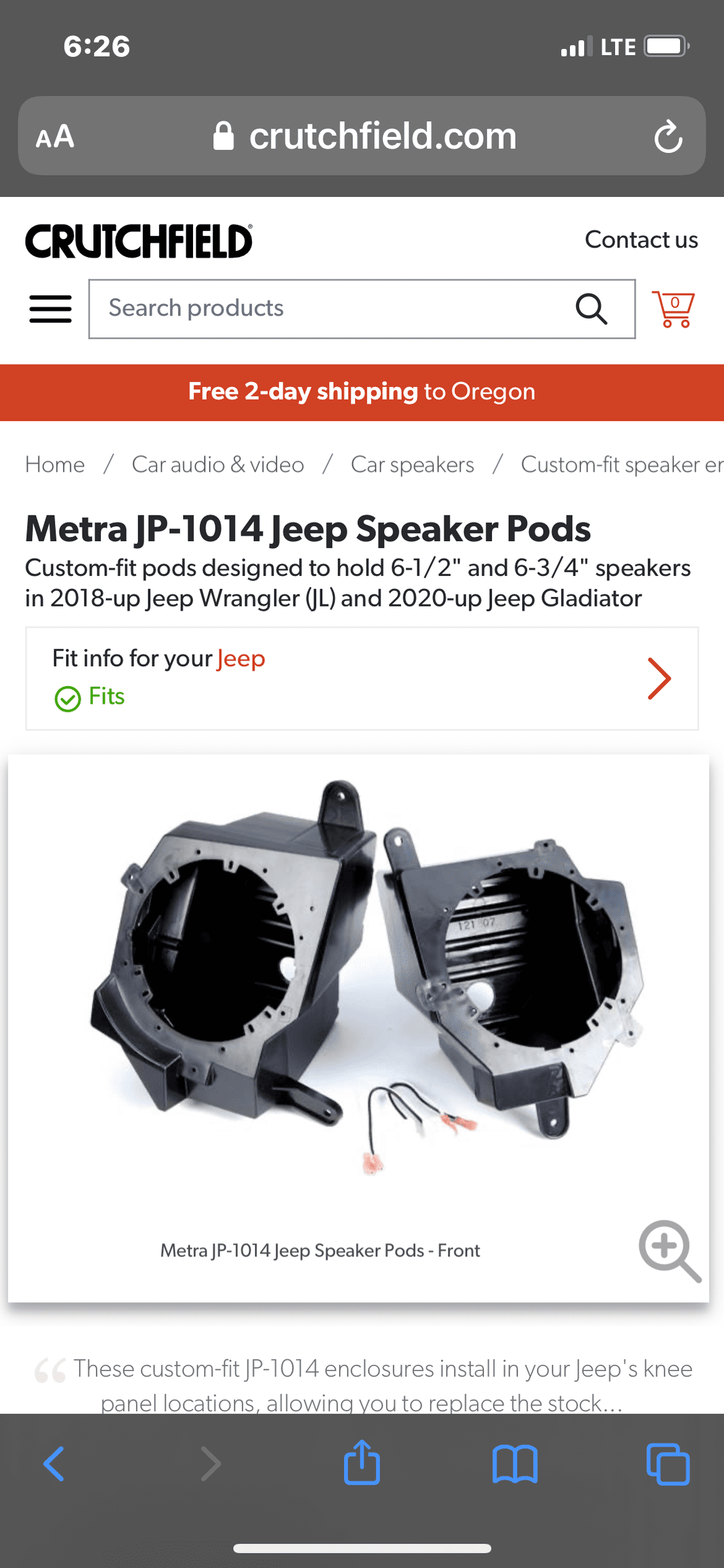

also doing the Metra knee panel pods for 6.5s.

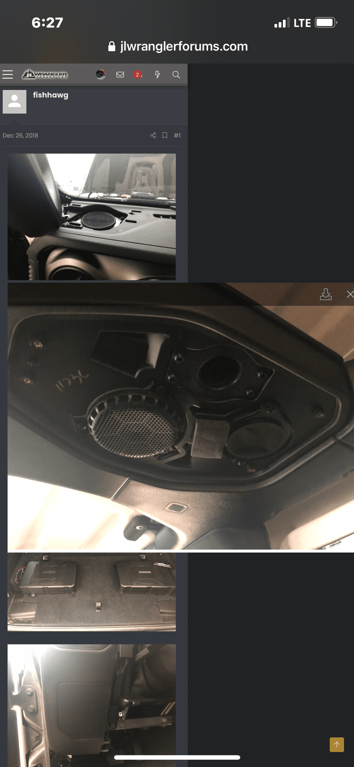

this is just for 6.5s going in the roll bar (soundbar) and aftermarket speaker pods that replace the ones in the knee panels. The Jeep came stock with 4” speakers in the knee panels and a 4” woofer with 3” tweeter in each side of the soundbar.
