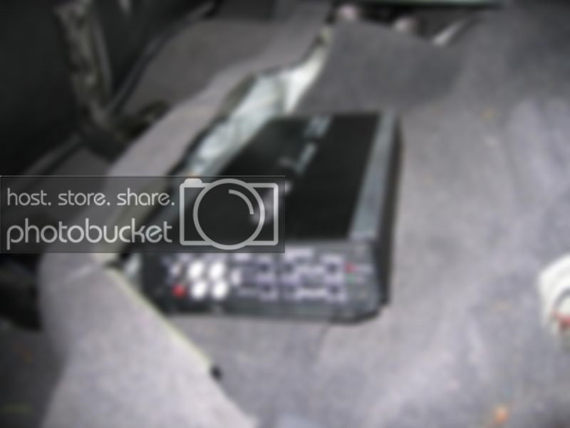

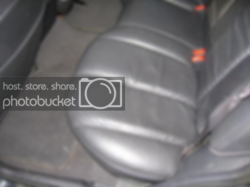

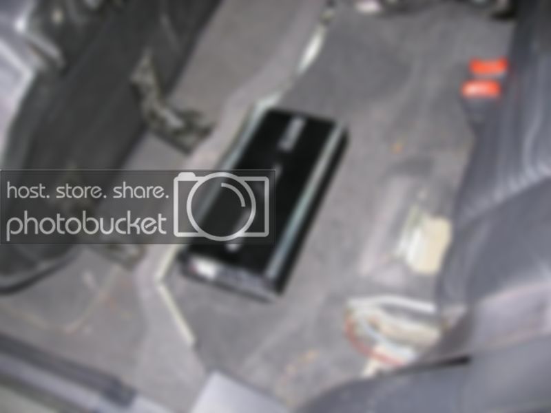

Did a little mock up where its going. There are extra wires under the carpet, that's why the amp isn't sitting flat. I will probably use some L-brackets to the left of the amp to secure it, and something on the rear to keep it from bouncing around.
There is almost 2" of clearance between the top of the amp and the bottom of the seat. Should stay pretty cool under there, especially since I will not be pushing it hard at all for now.
