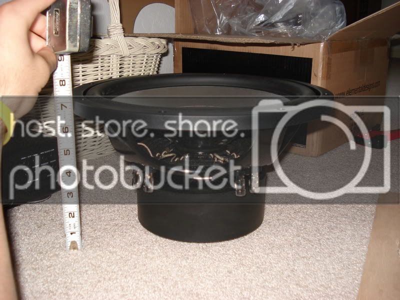

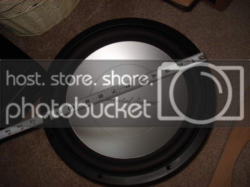

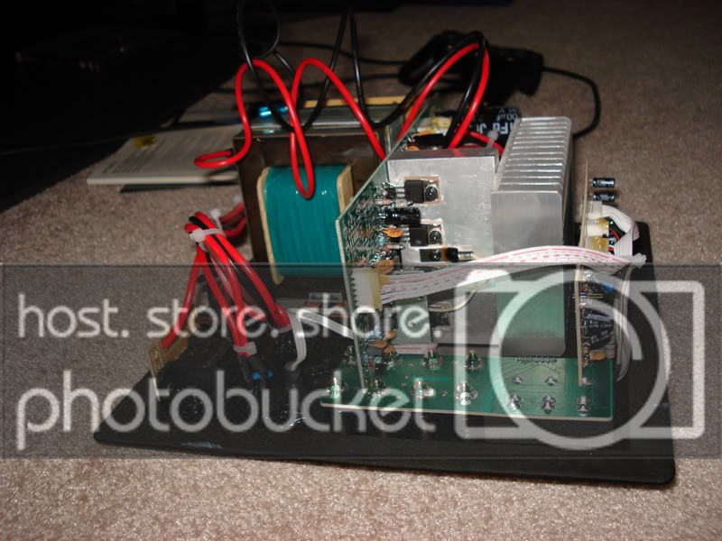

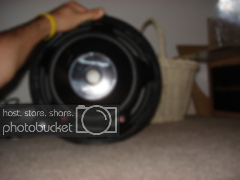

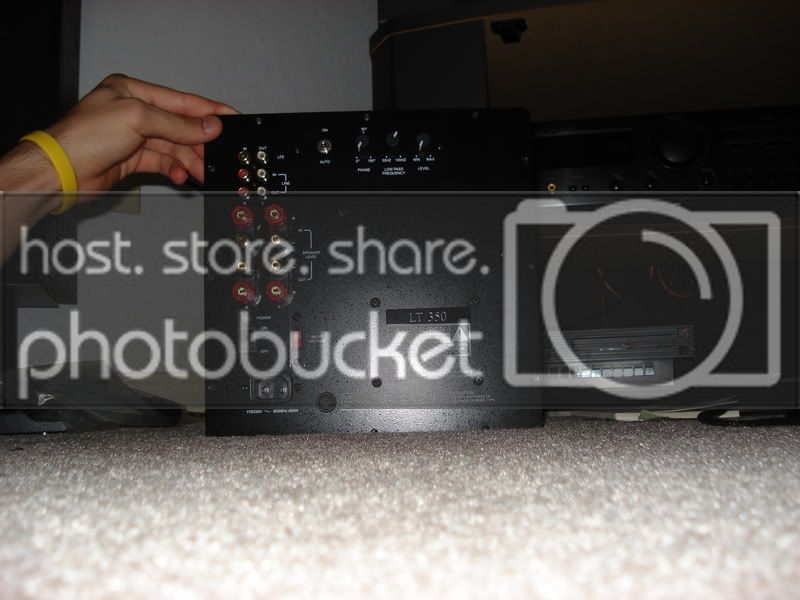

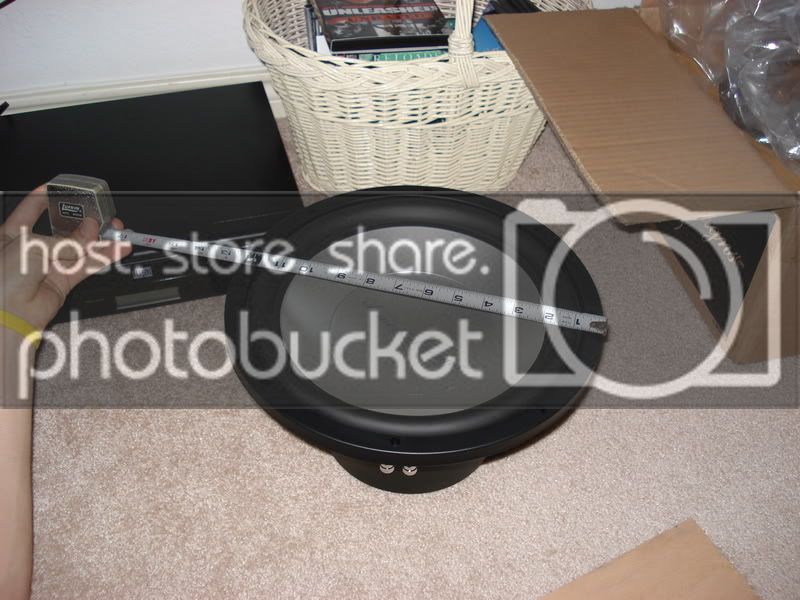

I'm building a home theater sub for my apartment and I decided on some ED stuff. I was originally looking at stuff from parts express but I could get a plate amp with 350watts RMS for the same price as a 250watt amp from parts express. Also, they had some "B-stock" 13oV.2's that were only $110 so I decided that was what I would do. B-stock, for those that don't know, is cosmetically damaged in some way. Functionality is not compromised.
PICS!

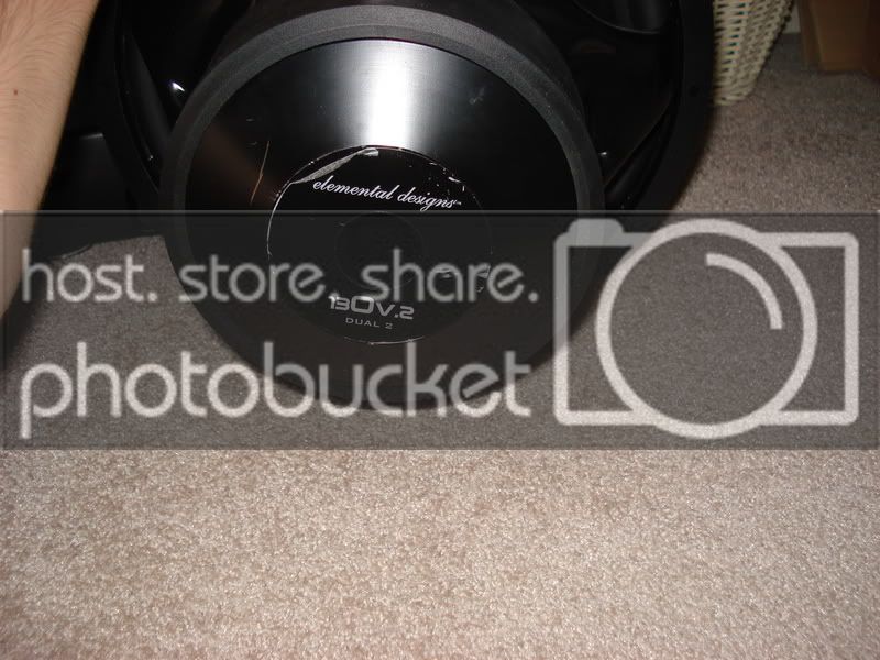

Here is the "cosmetic damage".......I guess I'll have to live with a scratched sticker:laugh:

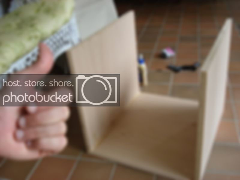

I've already started....even before the stuff came in //content.invisioncic.com/y282845/emoticons/naughty.gif.94359f346c0f1259df8038d60b41863e.gif

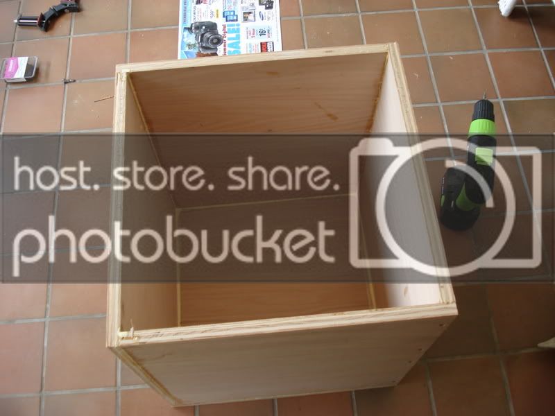

It's going into a box that's a little less than 3 cubes before port and sub displacement. It's going to be tuned to about 28hz. The guys at elemental designs told me I should tune it to 20 which sounded too low to me. Someone else confirmed that it was too low and told me 28 would be much better. The port will be a 4" precision port that should come in the mail tomorrow. I still need to get some isolation feet for the box though.

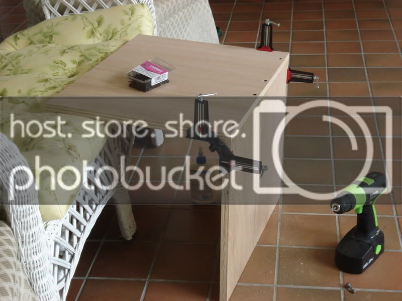

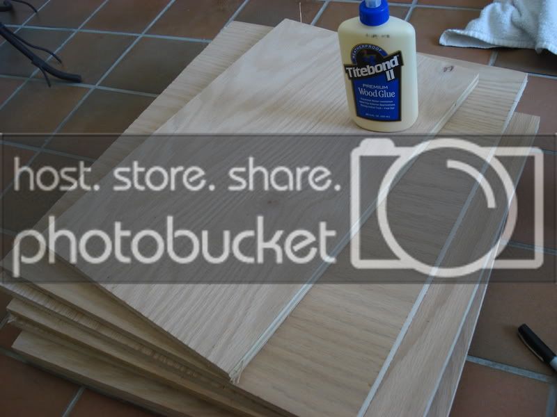

I decided on birch wood for the box this time. I figured it would be a piece of furniture (most likely a small table) so I would try and make it look nice //content.invisioncic.com/y282845/emoticons/smile.gif.1ebc41e1811405b213edfc4622c41e27.gif I'm using black Onyx stain and a clear polyurethane sealer to protect it. I think it should come out nice. Here are some progress pics...
