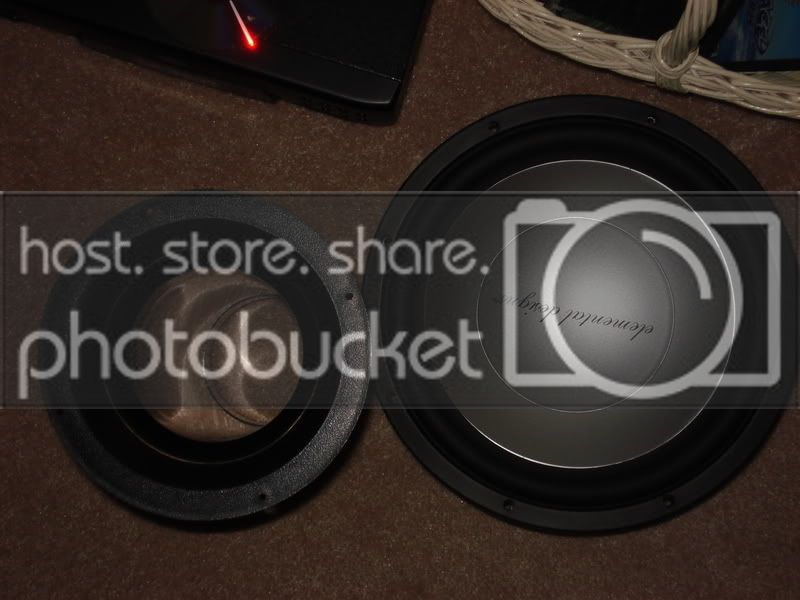

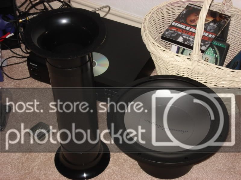

The port came in yesterday. I knew it was a 4" port 18" long but I didnt quite grasp the magnitude of just how big that actually was. Pics explain.....

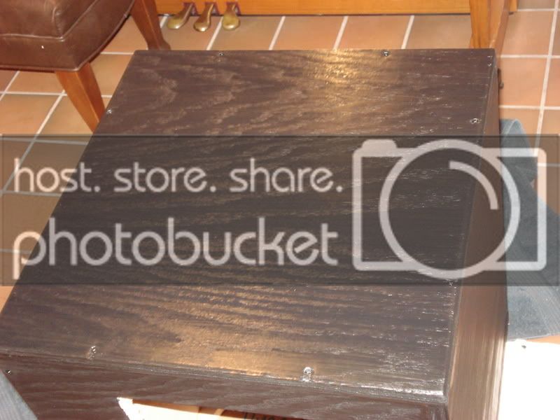

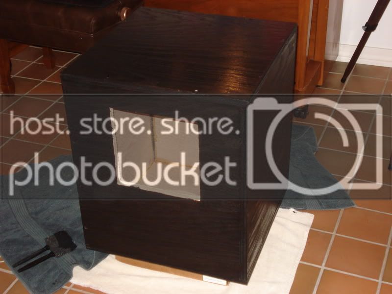

I pretty much finished staining the box last night. I had the box raised up a little bit that way I could do the top and 4 sides, then once they dried over night I turned it over this morning and did the bottom face (where the sub and port will be) before I left for work this morning. I have to seal it with polyurethane sealer after the stain sets completely. I'm surprised how well it's coming out, it's really going to look nice I think:yumyum:
