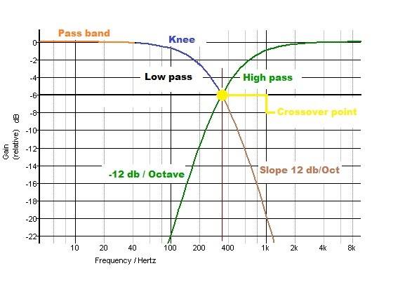

Well... read up on what crossovers are, high pass, low pass, band pass etc... google is your friend. then Look up on passive VS active crossovers pros and cons (again... google is your friend) proceed onto reading my posts.

I'm just gonna leave some pics explaining what crossovers are...
So refer back to that youtube vid where he had a nasty peak. Instead of EQing, he could choose a different crossover point and slope to tame those peaks. So if the RTA measures a peak and your new crossover point is now right at that peak, you are taming that peak without having to fk with the crossover and this method results in much better, smoother and detailed sound vs just EQ'ing to tame things.
This is a slope btw.
PS: loud and clear is baby sh*t. Soundstage and detail is the next level stuff that transcends hearing noise to actually hearing music properly for the first time in your life (loudly as well)

So, I'm even more confused than I was before. I learned a little bit but IT just brought me more and more questions. To start What is a band pass filter? What is a high Pass filter? and what Is a low pass filter? And how do I know how to use each one? Also how the hell do I go active? I'm extremely confused do I need to buy an RTA? or a DSP? or another amp? I have absolutely no Idea what all these equipment does and what I would do to go active? Another thing I really, really don't understand Is the "peak" What is a peak and why is it bad and why do you want to fix it? Also why do you want to play pink noise and do all this fancy stuff with a microphone?
