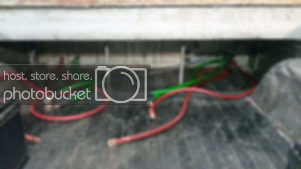

ok,so i am goin to assume you have properly sanded paint to bare metal, AND have properly sized power wire for ground/power. On that note, how is your power wire routed? check if it has tight bends that could have weared and be shorting out?

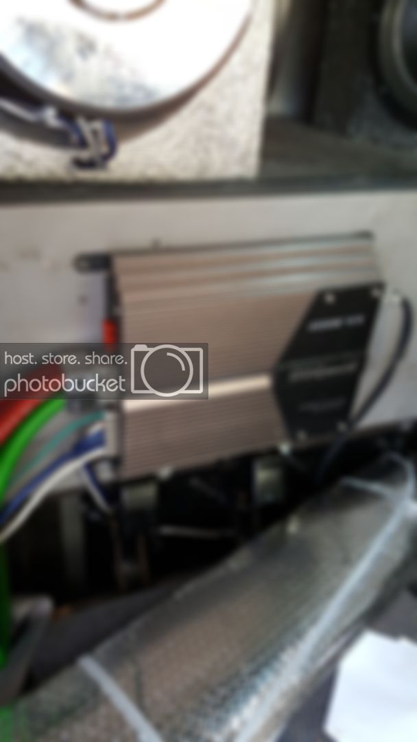

Like I said from the beginning. I know what I'm doing. I didn't make this thread to ask advice. The reason the fuses keep popping is because the amp is wired to .25 ohm and its pulling more than the 90 amps of current that's it's fused with from factory. So none of your advice is going to fix my problem.

Thanks. I'm redoing my amp rack that houses the 2 AQ3500s. I stuck this amp in there temporarily just to play with. So far it's done 148.6db on the powerbass

The manufacturer picked the fuse ratings based on current tolerance of internal components. They are protecting the amplifier.
There is an underlying issue that is causing it to blow the fuses. Because you say it happens when you turn it up, I would assume it is either heavily clipping or there is a bad electrical connection that is causing the amp to draw more current than it should.
If you put in larger fuses and the amp pulls the same amount of current, instead of fuses blowing, your amp will.
